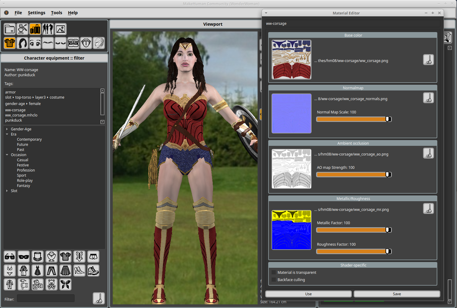

Meanwhile I made a small new material editor to allow first modifications of materials.
material editor
I want to fully support glTF materials because most game engines can read it, but also blender is reading it.
My own mh2b format uses the same settings as blenders glTF loader, but also creates a "look-alike" AOMap in Blender (it is a fake, but should demonstrate the usage of the texture with an effect at least).
gltF materials

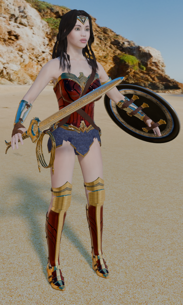

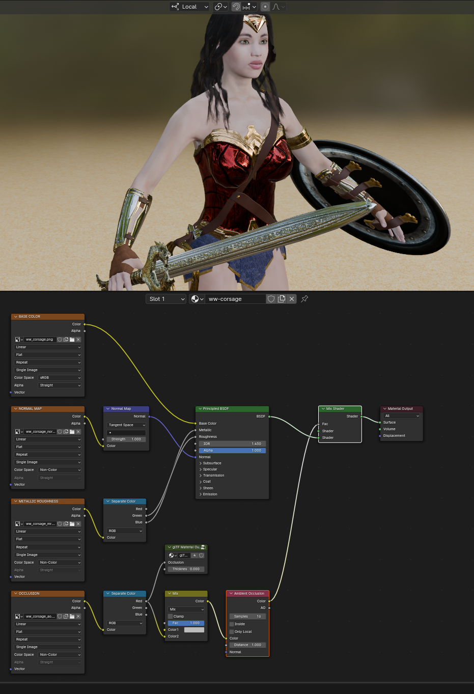

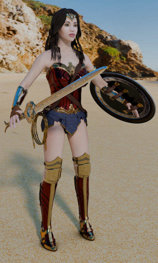

For the corsage. vambraces, shield and also boots, there are areas of leather and others of metal, there is also different roughness. Both is done either by values or channeled textures in glTF.
The unchanged result after loading in blender looks like this, this is the eevee version:
eevee version
And this the cycles one:
cycles version
The own shader in MakeHuman is of course not yet able to handle all that ... this needs to be done later.

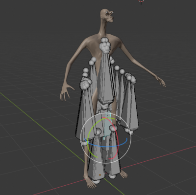

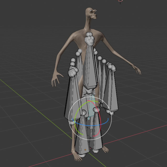

I already continued to put them into glTF exporter. So for testing: Do not call the export with a skeleton selected except you want to be suprised ... yes they already somehow do something in Blender:
our new standard mesh :)
:shock:
Meshes with deleted/hidden vertices will create problems, because the weights are not yet attached to the correct vertices of the "shortened" meshes.
And meshes using a different skeleton need to recalculate weights ... this is also not yet added,
The guy in the image uses a bunch of inverse bind matrices, which are not calculated yet (atm. I use the identity matrix before I start using my brain how to calculates these). And it uses only 4 weights per vertex as a maximum at the moment ... which is NOT the limit as I learnt in between.

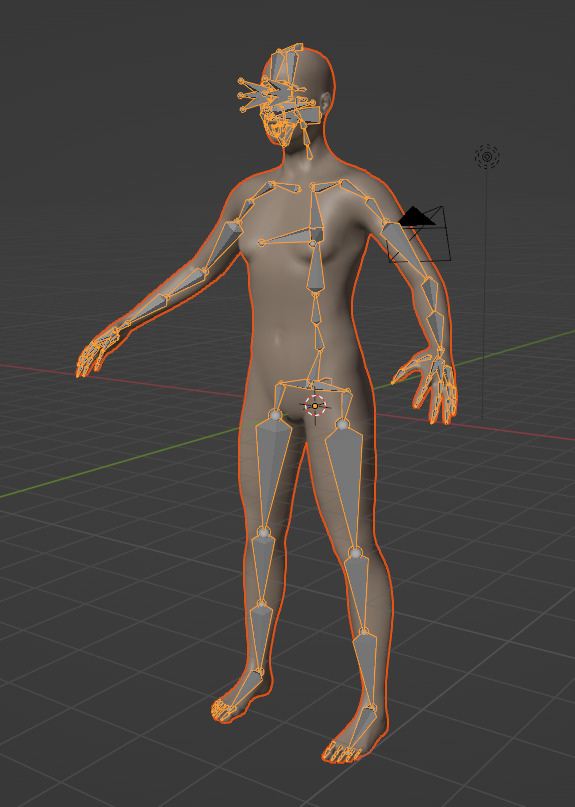

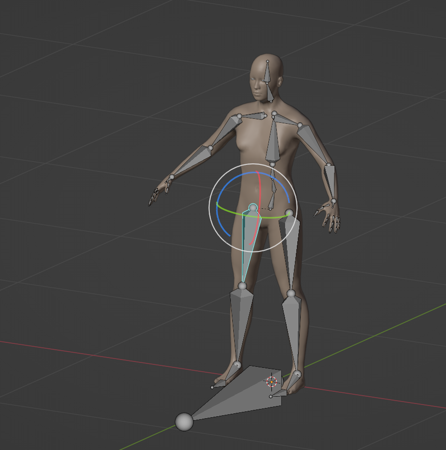

But finally I managed to get a skeleton (still not scaled and no feet on the ground) via glTF export to blender. I remember that I was pretty sure I can do that, but that was more complicated than I expected.
So yes, we have most of the components inside makehuman (also the old one). We need the inverse bind matrices for each bone, which can be derived from the global rest matrix.
We need transitions and rotations in local coordinates, which can be derived from the local rest matrix.
Do not expect, I knew all that. :lol: I found that out by comparing Blender output with my own output.
So yes, quaternions are needed for rotation and hey, we have an algorithm for that in old makehuman, let's reuse that algorithm.
A typical unreadable high efficency coding ... and wrong.
There is a non-precise mode, which let point the bones in all directions and there is a precise mode which crashes seven times on singularities with our skeleton. Well the reason for crash is rather obvious ...

Postby Ricardo2020 » Sun Oct 06, 2024 12:27 am
Are those hands poking out where the eyes would normally be?
Posts: 277
Postby punkduck » Sun Oct 06, 2024 8:32 pm
Ricardo2020 wrote:Are those hands poking out where the eyes would normally be?
No these are the 3 eye-bones, they are just longer than in the blender version created with mhx2. As I wrote before, a bone needs no length and so there is no length saved in glTF.
As a proof, you can export a character imported by mhx2 with gltf in Blender and reload it. Of course you need to get rid of the stupid icospheres when character is standard size (decimeter), therefore deselect shapes in panel.
Exported in standard size (0.1 for glTF, this works since one hour ;) ) ... the icospheres replace bones as shapes. I think the idea of using this in Blender is worse than the normal bones they had normally.
For the length of these bones they use the parent bone ... at least it looks like that. Our eyes are connected with two (not needed) dummy-bones to head bone. So the leaf bones will mostly be wrong. But you can also see differences with the neck bones.
It is just one representation of a bone. In FBX it is the same. They often add so-called leaf-bones which exactly had one purpose to show the length.
For the blender exporter I will add the length, makehuman internally knows headPosition and tailPosition of the bone, because that comes with the skeleton-definition. That is, btw. the only reason for the 3 cubes in front of the eyes, when you check our helper.
Needless to say that scaling and using an offset was creating a resized skeleton for glTF export because the complete rest matrices etc. had to be recalculated. And I thought adding a value would be enough for an offset, so the "I do that in half an hour" just changed to "it took the whole Sunday" :lol:

game skeleton export with gltf, odd bone-rolls included (partly)
So next step done. It looks like extra skeletons like CMU or Game skeleton seem to work in Blender export and glTF export also. We are not working with own weight-files in these cases. We are using reference entries for that, so like
Forearm.L = [ lowerarm_01.L, lowerarm_02.L ]
So we have to sum up weights. Fore things like eyes we have to figure out the next existent bone in hierarchy, because our eyes consist of 6 vertex groups but none is referenced directly (the next back in hierarchy is head),
Then we have to append all these values per new bone, do a numpy.argsort and a numpy.unique ... And then we have the correct weights.

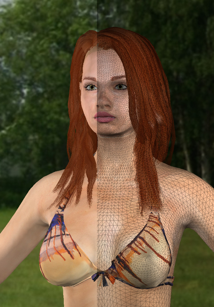

subdivision (smoothing) for triangles
So inside renderer, subdivision meanwhile partly works. it looks rather correct, but there are still glitches, some UVs are wrong (usually where the seams are), the jittering boundaries (hair) seem are not correct (because the first method I found had an error).
When you look carefully you can see where quads had been before. Some of the lines in inner mesh are not really straight, but others are, that could be another error somewhere or it is a problem of the algorithm itself.
it is mostly pure python, no numpy. I changed part or the calculation of normals to numpy and there will be changed more to be faster. Since numpy usually hides the algorithm I will add MD files later which should contain the "original code".
Subdivision will only be used in the renderer. It is simply too slow (and one cannot compare that to the old quad mesh). And of course this renderer will have a small amount of features, but it is not comparable with what a game engine or Blender can do. At the moment all graphics I used is still "just to see something".
