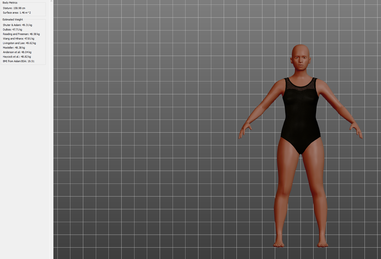

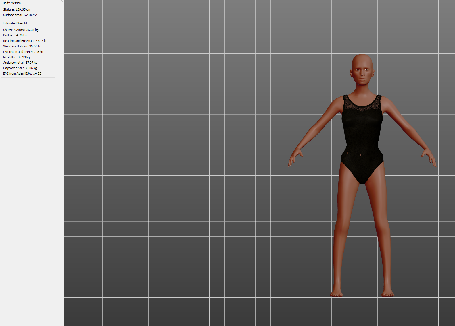

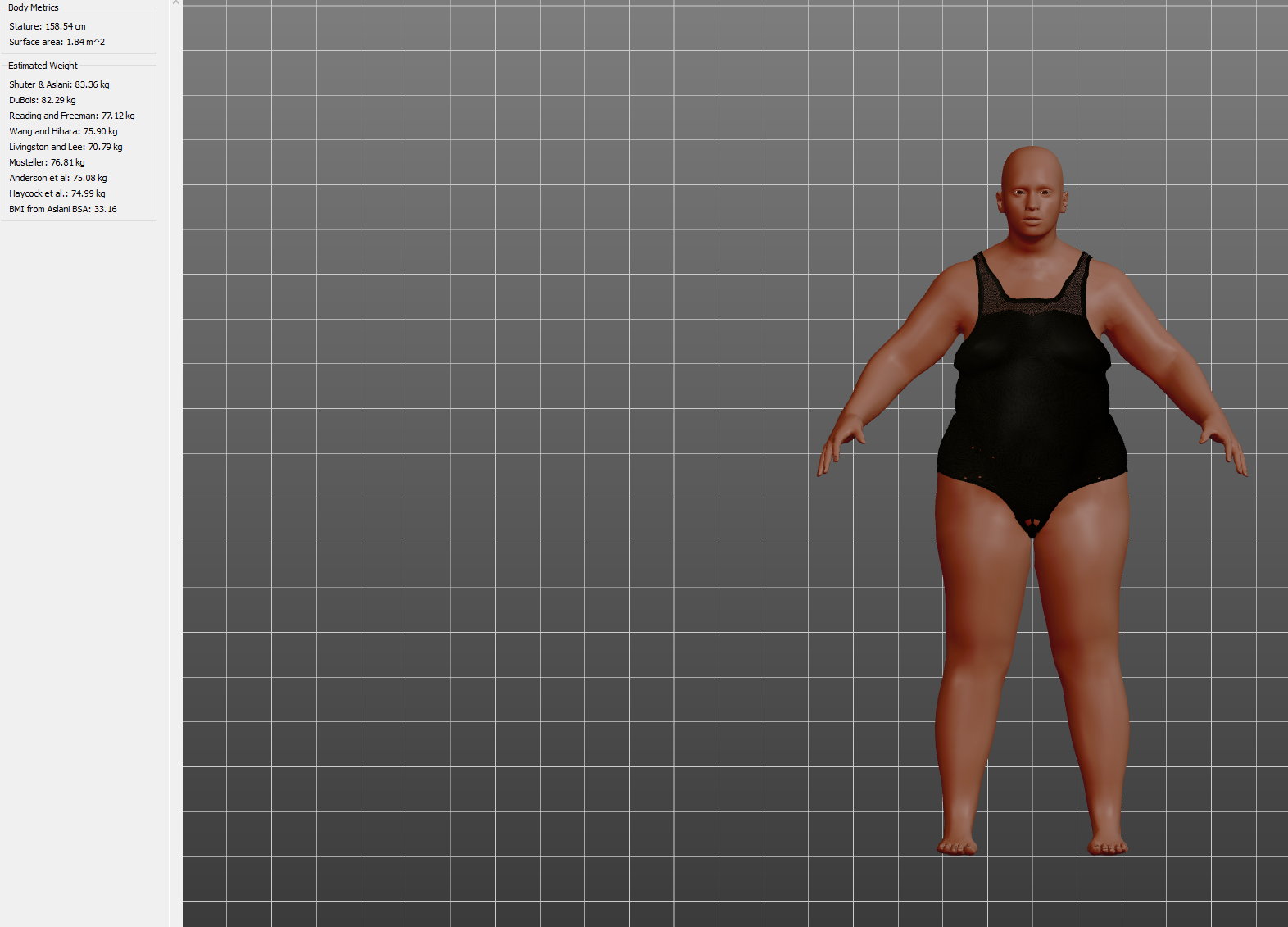

Here are some screen shots of the results...

Re: Weight estimation plugin now available for 1.1
