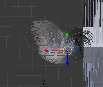

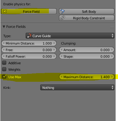

How interesting is this - if you add a bezier curve, edit it and make a little curl, once done, go to the physics tab and enable force field, also enable use max, this allows you to control how close the hair needs to be in order to be affected.
now as you can see in the following images, i have my curve with its max set to control the entire clump, and as i move it closer to the hair the hair then takes that curl - Thus i was thinking that if you had long hair, and put a few of these down the side of your models hair, the result would be quite quick easy cute little curls.
