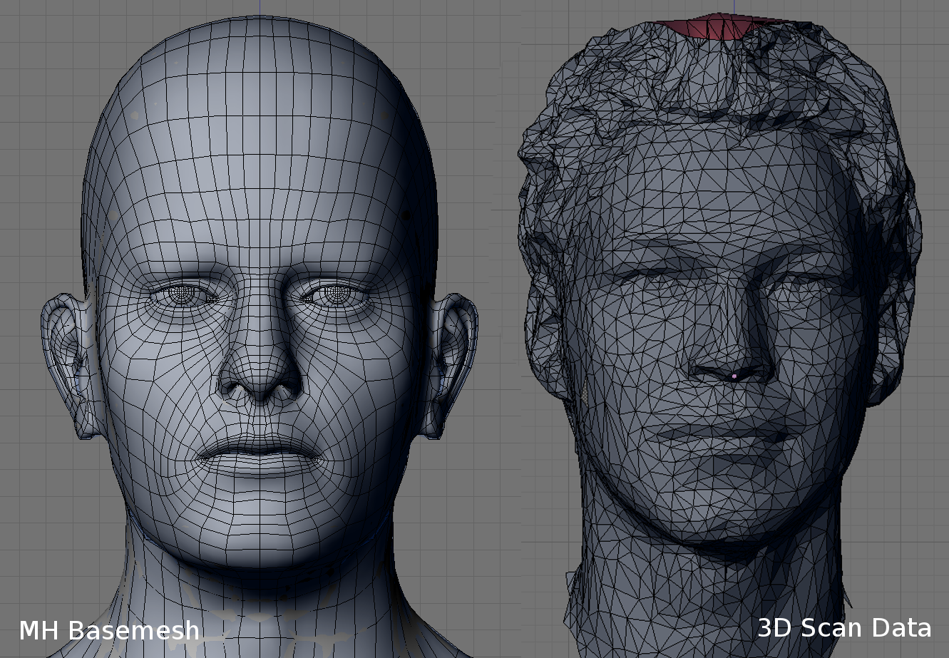

duststorm wrote:The power of MH lies in the fact that we use a very high quality basemesh with good topology. This makes it an ideal fit for animation and for editing by artists (both in classic 3D editors like Blender or Max, or with sculpting tools), as it is constructed entirely of quads instead of tris.
tris are acceptable in a polygon mesh. the Popular catmull-clark subdivision (limit) surf differentiate between poles and n-gons as they are converted to quads(and poles) after the first subdivision.

duststorm wrote:The raw result of such a scan is an unordened surface of triangles that are quite randomly placed. This is very difficult to edit or animate without retopoing it first.
I believe that MH has a very strong potential for creating animateable characters from 3D scans.
