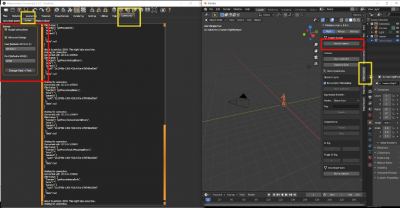

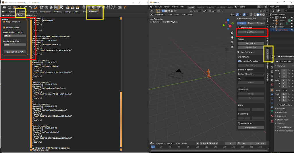

Perhaps I misunderstand what you want, but see the image below. In MH you need to go to Community > Socket tab and accept connections and you might as well check Advanced settings so you can see what is happening but you needed I don't think. Then in Blender delete the default cube, bring up the "N" panel and click the Makehuman tab on the right. Within the Makehuman panel click import Human. You should see the human from you current MakeHuman interface in Blender just like magic.
If this is not what you want to do, ask a more complete version of your question and I'll try again.
