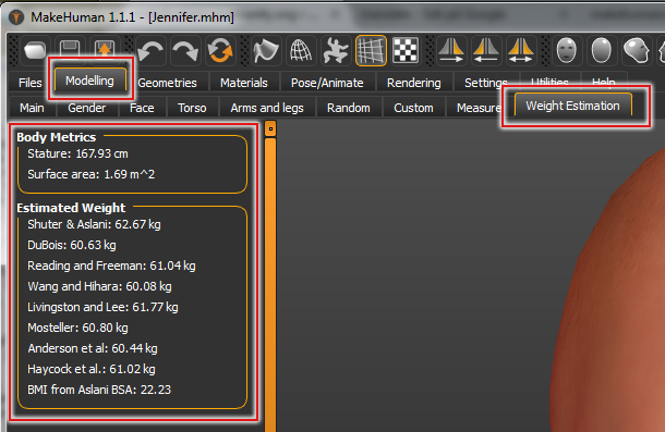

I don't know if this may be of help but jujube posted a weight script here viewtopic.php?f=9&t=15081
Install it by placing the file "7_weight_estimation.py" in "Makehuman\plugins" and it should look like this
It has no weight input but when changing the sliders the characters weight changes.
