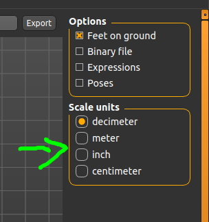

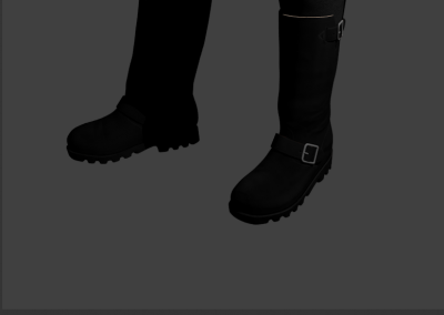

So I made a character in Make Human version 1.1.1. I imported it into Blender 2.79 using .mhx2 format. The problem is the character is appearing too big in Blender. I can also not do any transformations on it. I am getting error "Object have no data to transform". Also when i render the image in Blender it's only showing legs of character instead of complete human. I have tried Transforming in object mode. I have also tried decimeter,meter, inch and centimeter. Still no result.

You can set the scale when you export from MH.
After import scaling, translation and rotation are locked for the meshes. This is at least true for rigged characters. If you want to scale a rigged character, select the armature, switch to Object Mode and scale the armature.

Hey thanks for quick reply! Unfortunately I still couldn't resize the character even after selecting the armature and applying scaling transformation in Object mode. I have imported using Decimeter unit. Other units are giving me even larger result. Also character is not rendering properly in Blender. I have also attached screenshot for reference. Is there any other way to import normal size characters into Blender and then render them without any loss?
