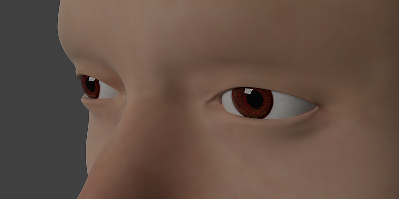

Postby blindsaypatten » Sun Sep 24, 2017 3:08 am
After putting this aside for a while I got back to it today and made a little bit of progress.
I decided that the easiest way to stay clear of modifying MakeHuman itself was to extend the .mhx2 files, so only the Blender importer needs to be modified. So, I added support for an auxmaterials section following the material property for an object. The auxmaterials consist of a material name from the list of materials in the .mhx2 file, plus a list of the faces, by index, that the material should be assigned to. No changes were necessary to allow adding additional materials to the list of materials in the .mhx2 file. My importer will now handle the auxmaterials entries and set the appropriate material on the specified faces.
In addition, if the Transparent property of a material is True my importer now makes the material glass. For now it just uses the default Glass shader with no setting of additional properties. That's enough for my current purposes but I'll come back and look at what else it should do, and set it up to use the principled shader if that makes sense.
For now I have to manually modify the .mhx2 file so the next step is to write a script that reads a .mhx2 file, looks up additional materials based on object uuid, and insert the additional materials and auxmaterial sections.
Although it has a ways to go, I get a certain degree of satisfaction out of being able to import a character and get proper-looking eyes without having to make any modifications manually in Blender.

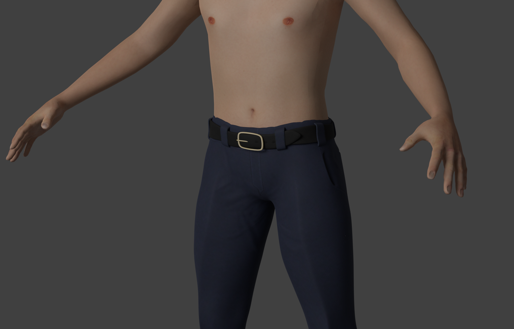

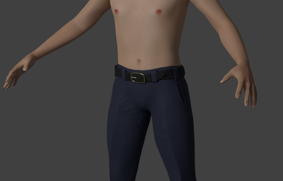

Postby blindsaypatten » Mon Sep 25, 2017 4:40 am
I used the principled shader metalic property to make the belt buckle on the pants shiny, and just for kicks made the fingernails on the body a separate material as well, although it isn't as visible as I had hoped. Actually two materials, one the nail where it is in contact with the skin and then a second for the detached (whitish) part.
What it looks like by default
