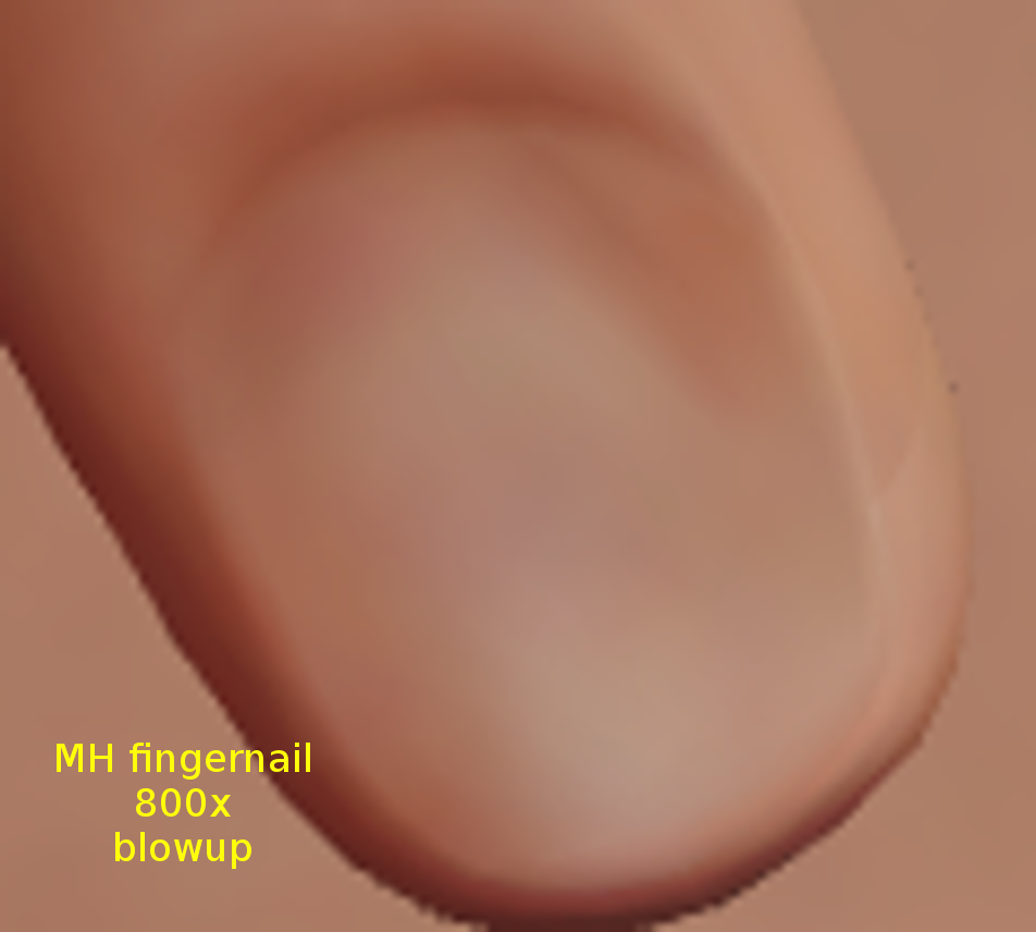

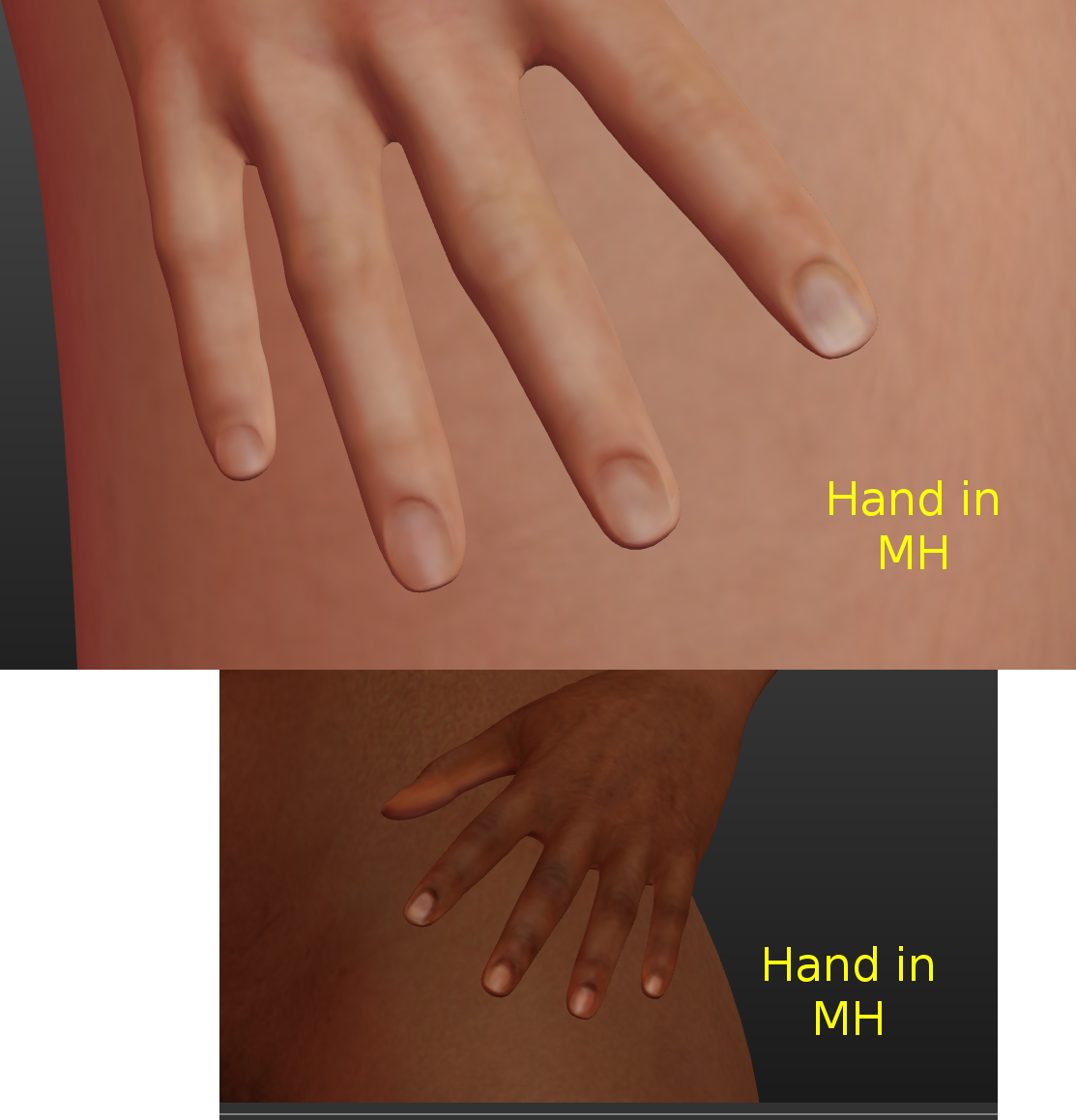

The fingernails are another story. It looks to me like something has happened downstream to the geometry of your fingernails. Did you inadvertently do some smoothing on the nail beds? Although I agree you might have applied a Gaussian blur filter to your texture image, you also seem to have lost some underlying geometry along the way.
Here's what I see in Mh and I think there is clear loss of detail in your images:
mh n
MH hands
fingernail 800x blowup
MH Toes
Perhaps you corrupted the textures during your workflow. You could try downloading them again.

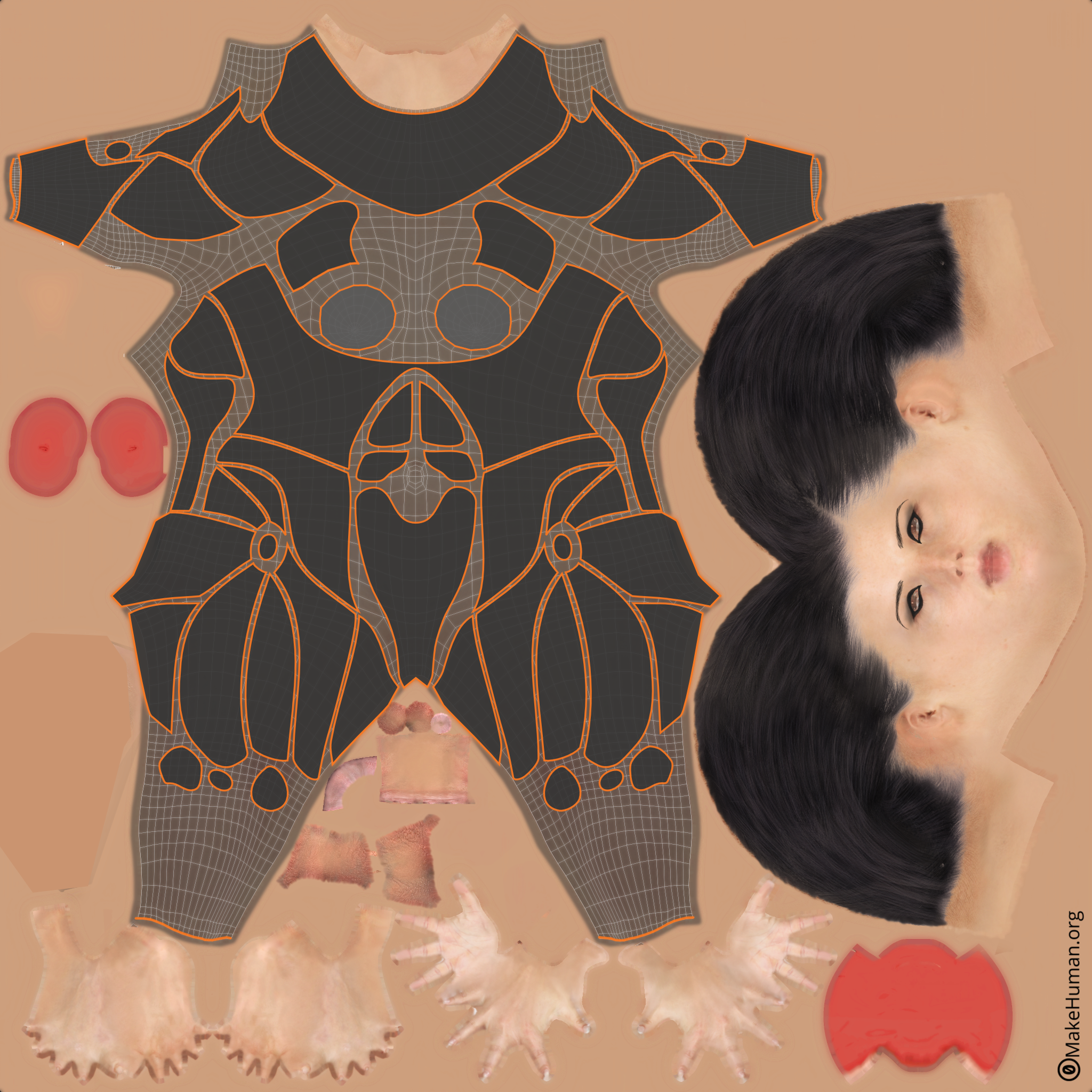

If your character is going to be completely clothed, say except for hands and head, you might experiment with optimizing the UV map so that the parts that are covered take up very little of the image and the parts that are visible take up most of it. In this image using the default UV map all the space taken up by the suit, the hair, and body parts that won't be visible can be shrunk down to a small area, and then the face, neck and hands can take up most of the image. If you do that you can get a much higher resolution face in a 2048 sq px image than with a 4096 sq px image using the default UV. The face is just 450 sq px in the default UV image. Just an idea, I haven't tried it. If you do try it, the UV map you produce would be a nice contribution for the repository!

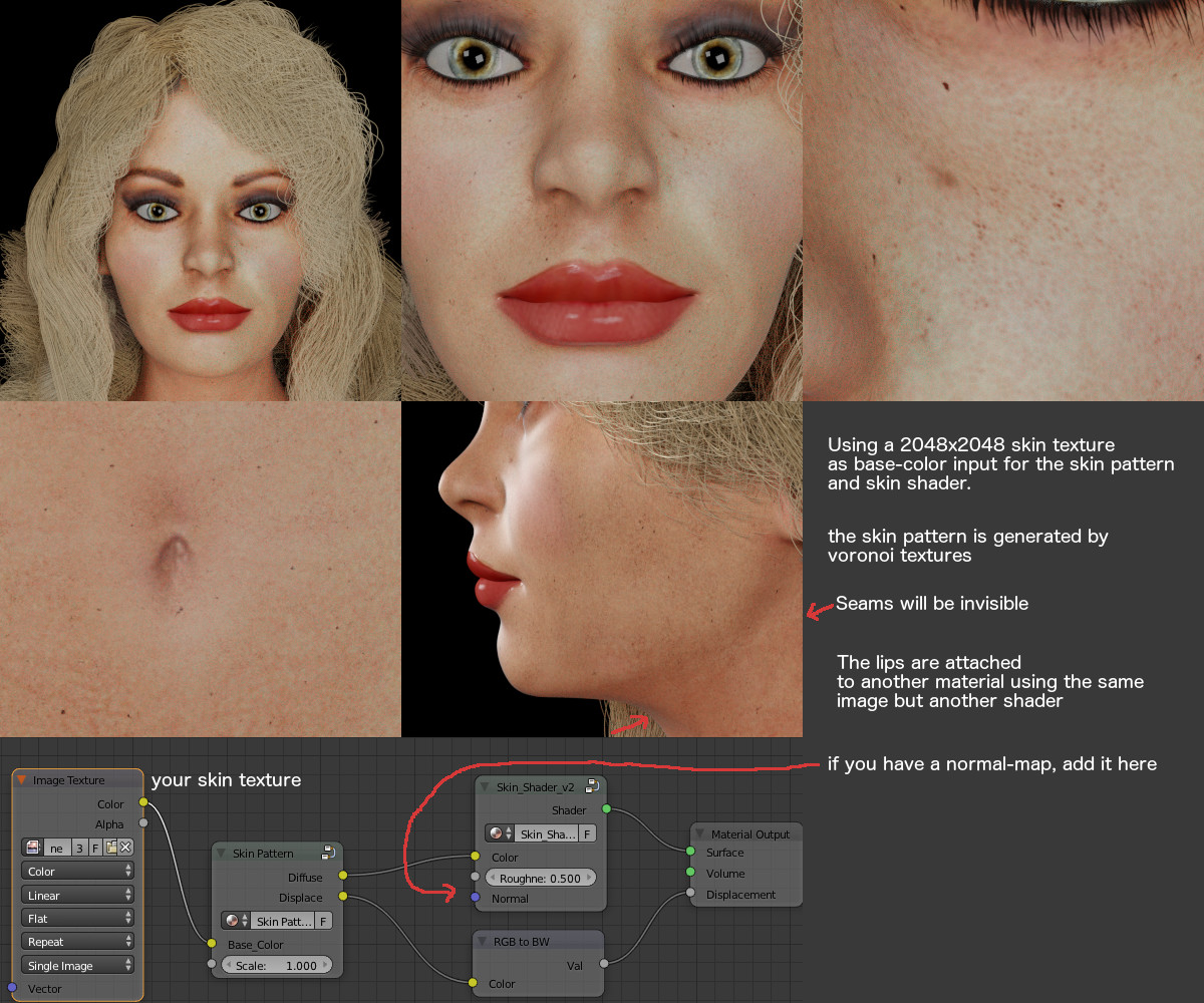

Hi, I'm one of the hard-working persons doing own skins. I stopped at a size of 4096x4096. It is a lot of work, but for my models (also for the next one) I always create a skin, but uploading is not allowed ... sorry. How a 4096px texture looks for the face you can see in detail in my "daily life of models" topic on the first page.
Before I created these models I worked with slightly changed skin textures, e.g. tan-lines added to the 2048x2048. And I had problems doing that. The face is more than 2 times bigger than the body! Ever noticed the seam and different blurriness between neck and face? However, when I read the article of the skin shader I tried the method on my old "low-resolution" characters. I will show the results here.
The best thing you can do is to combine a texture and the skin shader RobBaer mentioned above, simply download skins.blend from the thread.
Append the material procedural_skin_v2 from the file skins.blend, then attached it to your skin. Now change the material in the compositor to a simplified version (without the special makeup etc., see picture) using your texture.
For fingernails you should add "real nails" from the user contribution (better geometry). For lips and caruncula lacrimalis (sorry I only found the latin term) you may select all faces and create an own material using the texture and make the skin look wet or glossy.
In the picture you can see the face in different resolutions using texture and skin shader. And the seam between neck and face is invisible. I also rendered the navel section as an example.
There is a disadvantage: it needs more time to render the pictures because of the complex material (for the examples I used 300-500 cycles). You should try it ... ;)
