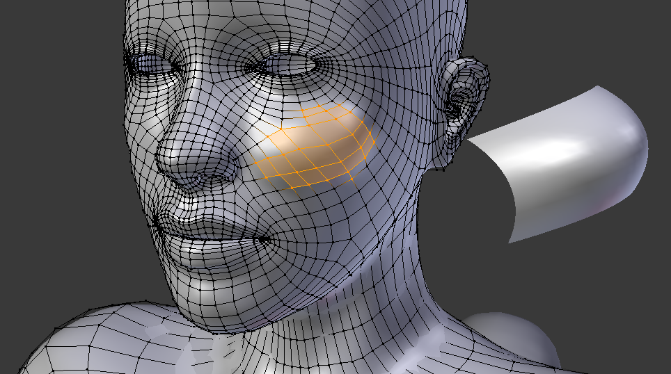

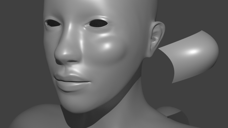

As a test, I created a nurbs surface in blender and converted it to a mesh, which I then embedded in the basemesh to roughly represent a cheekbone (although it looks more like a tumor). Once I had it where I wanted the cheekbone to be I selected all the vertices under the nurbs mesh and shrankwrap them to the nurbs mesh. I think the result is not too bad. The shrink wrapping result that is, it's a lousy cheekbone but that's wasn't the point. I moved the nurbs mesh away from the face for illustrative purposes, when it was positioned on the cheek the part that protruded was pretty much exactly what the resulting cheekbone looks like.
Now I just have to learn how to model with nurbs, beyond scaling. Also, I have to try this with a mesh from a 3D scan.
I think you could probably produce a decent bicep this way, other muscles too.
