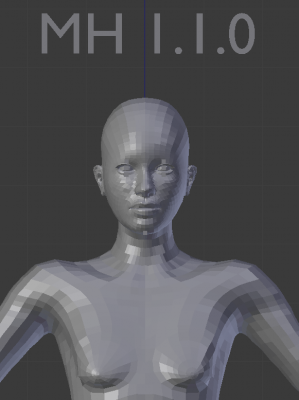

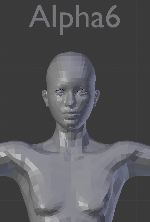

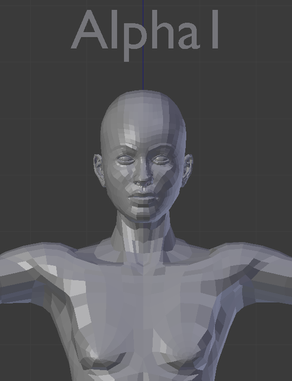

Postby jujube » Mon Apr 24, 2017 11:34 pm
I unzipped some of the old downloads to get to some of the ancient iterations of base.obj. I'm uploading the blend file for the convenience of anyone else who might want to play with them.
The most obvious thing is that all the alpha meshes are in the T-pose. ***The difference between alpha6 and alpha7 topology is surprisingly dramatic. They got rid of the clavicle! It seems they put back some of the definition in 1.0, but it doesn't have those lovely neck muscles that the old alphas apparently had.*** Also, for some reason I prefer the alpha1 eyes when seen from below.
(And while the "Professional mesh topology" wiki page says that only the current version is all-quad, it turns that so is the alpha6 mesh; only its joint helpers are quads. So it's not clear why the artists got rid of those lovely neck muscle loops. )
Lindsay, what are your thoughts on this? There definitely seems to be more shoulder muscle definition in the pre-alpha7 models.
edit: ***pretend I crossed out those three sentences; the topology is the same from alpha6 to alpha7, I just forgot to hide the tights helper when I took the screenshot of the alpha7. Also, I am a complete idiot.

It is a shame the neck tendons got attenuated, they are often cited as an important component of realism. The Alpha 1 ear is also way better than the current ear, it would be really interesting to have heard the conversation that led to that change.
I don't think the designer was very concerned with realistic musculature, I think they just wanted to get the general build with an expectation that either characters would have clothing on or that realism wasn't critical. Of the people posting on the forum I think we two are the only ones with much interest in realistic musculature.
It's pretty clear that the base mesh is a female character. I can remember wondering why the base mesh was different than the half and half startup mesh, and I can remember suddenly realizing why, but I can't remember what the reason was right now...
If you flip back and forth between the Alpha 1 mesh in a t-pose and the current mesh, you will notice that the modeler didn't account for changes that would occur to the upper-shoulder/lower neck area, they just bent the arms. In both the way the shoulder and chest muscles are merged isn't at all realistic.

The old topology basically has all the things I've been wanting, even my nostrils and ear holes! And I was wondering why base.obj has those sunken shoulders, so that mystery is solved. The alpha7 even has better topology on the tights helper - the current tights helper directly follows the topology of the human mesh, while the alpha7 helper shirt is made of nice neat evenly spaced squares. Honestly, I'm starting to wonder if it wouldn't be better just to return to the alpha mesh. It also has the T-pose which seems to be more standard in character creation.

jujube wrote:The old topology basically has all the things I've been wanting, even my nostrils and ear holes! And I was wondering why base.obj has those sunken shoulders, so that mystery is solved. The alpha7 even has better topology on the tights helper - the current tights helper directly follows the topology of the human mesh, while the alpha7 helper shirt is made of nice neat evenly spaced squares. Honestly, I'm starting to wonder if it wouldn't be better just to return to the alpha mesh. It also has the T-pose which seems to be more standard in character creation.

It is interesting how many faces were devoted to the belly button on Alpha 1, there is also more than a simple grid between the legs.
The ears are an interesting contrast, the alpha mesh looks like someone took an actual ear topology and tried to fit a mesh to it, the current mesh is clearly a very regular extrusion grid which has been smushed to produce something ear-like.

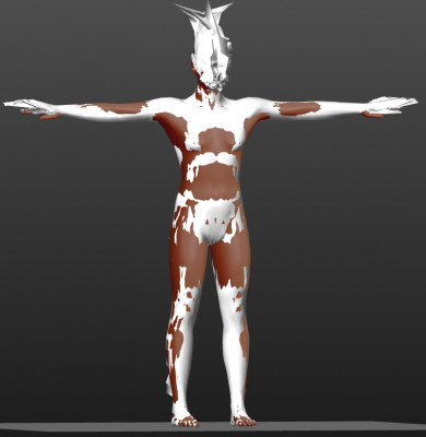

My first attempt at creating an alpha6 proxy:
Top image is base.obj, bottom is the 33% startup mesh.
For the longest time I assumed you couldn't make clothes on a posed/targets-applied mesh; I'm glad I proved myself wrong. It's just the head that's messed up. Which is weird, since the head by itself works as clothes:
The procedure I used:
1) create "basemesh with helpers" via makeclothes
2) with human selected, import default.mhskel (I wanted to link to the rig i/o addon here but I don't remember how to find it)
3) pose human to match alpha mesh
4) on human:
i) clear parent and apply armature modifier
ii) delete all the vertex groups except for mid/left right
5) make clothes
