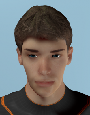

The built-in hair I used looked really good in Blender Render, not so much in Cycles!
Oops, forgot to set up the lighting.
Anyone have any quick tips on how to make the Blender Render look less like he is a wax model?
As a person who knows nothing about lighting, it would be great if someone who did could set up a blender scene of a photography studio that one could just plop the character into and have good portrait lighting. I know, I'm endlessly demanding but I think it would be a great convenience for a lot of newbies like myself that are already overloaded with learning MakeHuman and Blender without having to learn good lighting technique at the same time.

Glossiness / Skin like wax: the polygon hair (also clothes and sometimes the skin) look too glossy because the glossy input is white in most cases. The white is caused by the diffuse material settings, which is normally set to white or a light grey in MakeHuman. In Blender you can connect the color input of the glossy shader to the output of the image texture. You may also take out the fresnel node and simply put a low value for the glossy input in the mix-shader connecting glossy and diffuse shader.
When you connect the color output of the image texture with the displacement entry of the output node the skin will not be "flat". Put a math node between the color output and the displacement entry, set it to "multiply" and take a low value (e.g. 0.3). Otherwise the young guy will look like his own grandfather.

After doing the changes the skin should look like this ... (okay I've my own skins, but the shading is done exactly the way I wrote).
