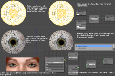

Long time ago I made my models using blender render, then I changed to cycles render. When you make that and forget the transparent node, the eyes are black. But normally, when you import the character already using cycles render, this will not happen (as you correctly mentioned). The eyes seem to be darker then in makehuman (well at least in my opinion ;) ).
But going this way I learned, how the eyes are designed. It is a double layer. One intended to be glass, the other one texture. In makehuman you get the cool effects, when you look into the eyes and turn the character because of a special litsphere.
Well, when you also think the eyes are too dark, here is my setup. I assign the outer layer to a pseudo-glass layer (to get a few effects, like mirror) and the inner layer contains the texture. Make the glossy node really white (#ffffff) for the glass! You then may simplify the texture layer, like I've done it. The rest is shown in the picture.
By the way that is only one solution to lighten the eyes. Emission ... hmm ... maybe for special comic character this is a good idea ;)
Maybe your character will look better when you make it my way. I don't know. I hope it has nothing to do with a GPU problem, because I also wanted to change from MacOS back to Linux somewhere in the future ..

Hi all and thanks for the kind suggestions. Punkduck, thanks for your nicely detailed description of how you do the eyes! This worked great. Here is where I'm at so far...
I tried to reproduce my own problem, but found I could not...they eyes were coming in kind of ok! But I am doing it on a laptop where I normally work on my desktop PC. So...I am thinking that it IS actually my GPU that might be causing the issue (Nvidia GTX 980) Laptop is using an Nvidia Quadro M2000M, but I get same result (ok eyes) with both CPU and GPU render. I will try on my desktop to see if I can reproduce the issue.
But anyway, with your method punkduck, it looks great...btw, I usually make glass the way you do - never have really liked the 'glass' node. I am actually making cartoon characters, but in my process I need to start out as realistic as I can get and then I change them with filters in Photoshop, so this will help me out quite a bit I think!

Postby blindsaypatten » Tue Apr 25, 2017 3:56 pm
I followed Punkduck's instructions and the eyes look 100% better. This leads me to the question, why isn't this the default?
