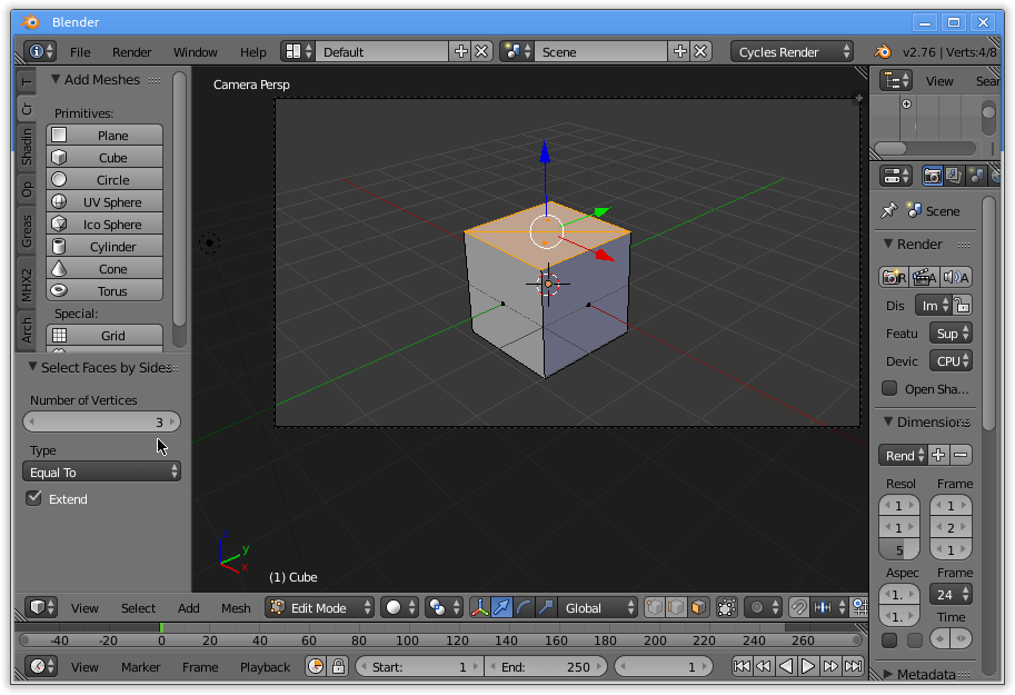

Aldun wrote:I keep getting the error "Cannot be used because it has non-quad faces".
It's entirely possible that the blender function still leave a few tris. You'll have to find these and fix them manually.
In the select menu there is a "select faces by sides" (probably only in face select mode)
When you do this you get a "tool" panel where you can set how many sides you want to look for Here I specified 3 to select all tris.
Re: Convert .obj to non-quad in Blender for MH
Postby joepal » Fri Feb 26, 2016 2:47 pm
Also note that you may have faces which have *more* than four sides. These won't be touched by tris-to-quads. So also try to select for five-sided faces for example.
