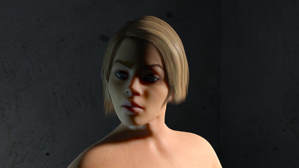

The simplest way, to avoid complex modelling, UV mapping and rigging, is to just delete the lower polygons of the long hair mesh. Cut to the length you want, this will retain UVs and rigging. It will look better if you adjust the map. To keep existing UVs, paint the edge alpha on the existing hair map at the cut-off point.
I probably could have spent more time on the alpha at the cut off, but you get the idea. You could shift the geom about a bit if you need to alter the styling further.

Not bad at all, except perhaps that indeed the edges are a bit noticeable.

Thanks. I rendered in 3ds Max with mental ray. The skin is 'Tony Sculptor Simple Skin' shader by Tony Raynolds which I have been experimenting with. I like it but have had better results with Master Zap's 'SSS Fast Skin+' shader, but maybe I'm more familiar with that one. Worth a try for any mental ray users.
I already had the model with the hair cut, but hadn't got around to altering the map, so I did a quick mask paint in Photoshop as an example. There is still a visible edge, so needs a bit more work. I followed the edge loop to not get steps, which gives an asymmetric cut, but some girls have that. The alpha could solve that if needed.
I was going to upload the map, but it's too big.
