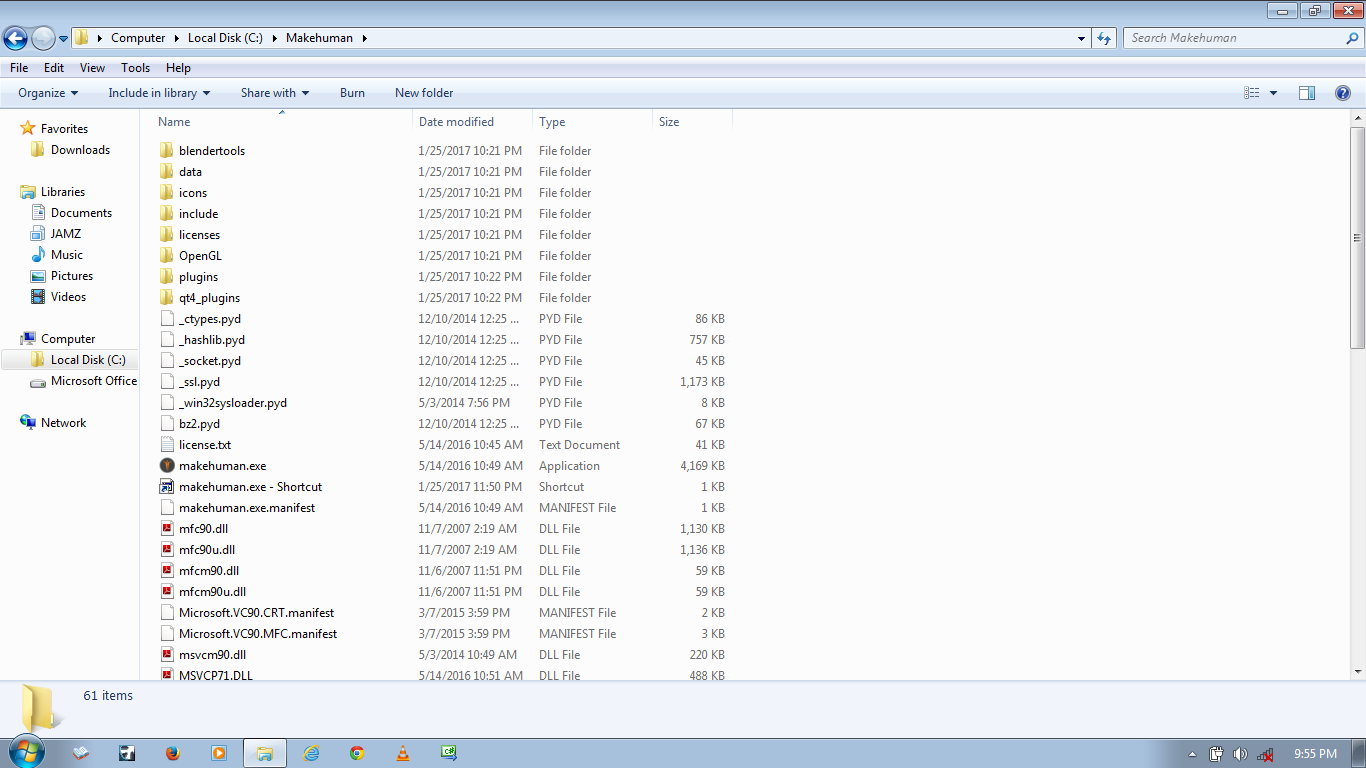

Make sure unzipping was successful, perhaps post a screenshot of C:\Makehuman. And finally, what about antivirus?

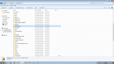

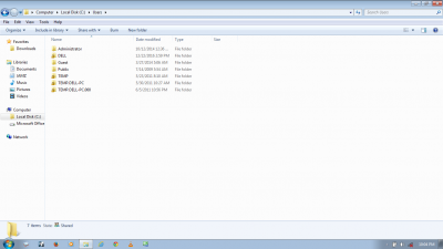

C user DELL MY dicunent
C user DELL
C\Users
C:\Makehunan
Inside c makehunan
Inside C\Makehuman
Inside C\Makehuman

I didn't want to see all you private files, you can delete this. On a quick glance the content of c:\Makehuman seems to be complete. No further ideas... Sorry.

Just one thing I noticed in the screenshots: The user, who is logged in and making the screenshots, does not have access to C:\Users\DELL (see mh5.png, the small padlock). The "...\Documents\makehuman\v1"-folder will always (!) be found in the documents folder of the user currently logged in, i.e. if makehuman.exe is executed by the user "Admininstrator", you will have to dig in "C:\Users\Administrator\Documents".

I think Aranuvir has found an important clue regarding how you logged in. If you logged in as administrator look for MakeHuman.log in "C:\Users\Administrator\Documents" If you logged in as guest, look in "C:\Users\guest\Documents" This file is key to us helping you further.
One other question. I see both a makehuman.exe and a makehuman.exe - shortcut in c:\makehuman Which are you trying to run? What does the "start In" line of the shortcut say if you right click and look at properties?
