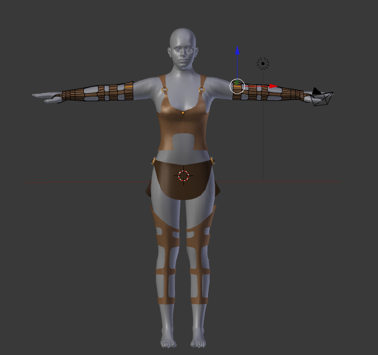

At the moment i work on this The cape comes later, unfortunately i have not enough time, to try all, what I want to try - Robes and Petticoats, Cloaks and coats etc - we will see, what finally comes out :roll:

Postby duststorm » Mon Feb 20, 2012 6:30 pm
Nice.
I think what you made now will work quite well with clothes script, at least if it may behave like fabric.
I would try to fit the hip cloth against the skirt helper, otherwise you will get trouble.
The leg parts can be fit like pants, upper body parts like a shirt.
I only fear a bit for the metal rings, it's possible they become non-rigid and scale when the body moves.

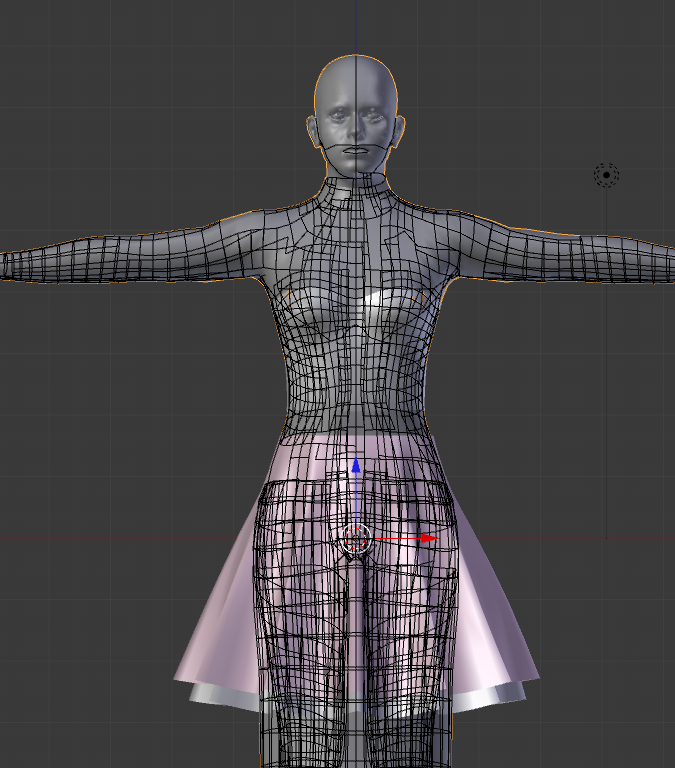

Modell a summerdress and fit the cloth to the helpers - but when i press "Recover seams" i got this :o

Postby duststorm » Wed Feb 22, 2012 11:13 am
Recover seams just creates an additional object with lines that show the positions of seams on the human model.
It's up to you to create seams on your dress model, using those lines as reference.
You have two options:
- press recover seams, create seams on your clothes that are as close to those as possible. It should not be very exact. Then unwrap your UVs regularly.
- press Project UVs, with clothes and human mesh selected. This uses the matching of clothes to body to assign UV coordinates. It will probably need a lot of tweaking, see my clothes topic for some tips.
Maybe the best approach is a combination of the two (I still need to try this). Since with projecting UVs the biggest problem is in the seam areas, you might save yourself some trouble by first marking the seams.
I advise you to use a separate UV map for texturing the model, as the masking UV map is not ideal for clothes. Use a second UV Map for projecting the masking UV coordinates onto.
