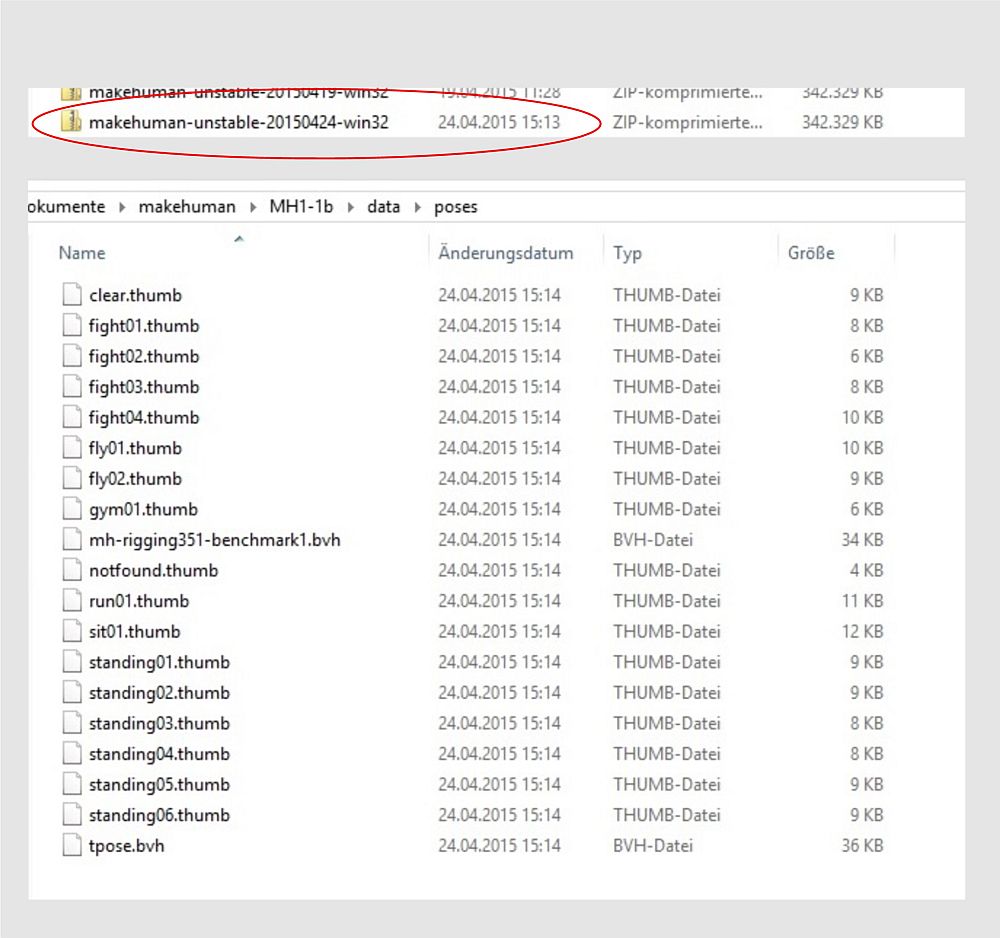

Yes, this is what I downloaded and what I get:

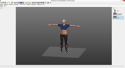

Looking at the screenshot, I see all pose files are ok. What's the problem?
Re: new pose system missing deb nightly?
Postby Déesse » Fri Apr 24, 2015 6:12 pm
Only the bvh.files that are located in the pose-folder are showing. Am I missing something? Placing my own bvh-poses does not work for me :roll:
Postby Déesse » Sat Apr 25, 2015 10:33 am
Hey duststorm, this is not the problem, usually I'm editing clothes in Blender and didn't want to show a naked model. :)
The problem is that using or uploading poses doesn't work for me like it is shown in the video.

Déesse wrote:The problem is that using or uploading poses doesn't work for me like it is shown in the video.
Perhaps MakeHuman doesn't see the poses due a path problem...
I see you have a folder named MH-1-b. Have you renamed it by hand?
I'll point Joel to this thread. He is the deb expert.

Postby Manuel » Sat Apr 25, 2015 6:31 pm
Déesse wrote:Yes, this is what I downloaded and what I get:
Ehi..we just noticed this is a Windows screenshot...this is confusing.
The thread is about deb...no?
