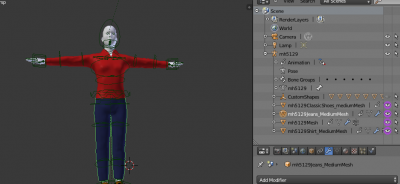

Postby doghouse2 » Wed Mar 19, 2014 3:58 pm
Here is the image of the file from 5120

Postby duststorm » Thu Mar 20, 2014 1:51 am
doghouse2 wrote:Here is the image of the file from 5120
Yes indeed. You will no longer see these types of diffuse colors because most clothes have diffuse textures. In order not to put those textures not through a color filter, the diffuse color is pure white (which means: don't alter the diffuse texture color).
The difference between then and now is that now MH has a material format that actually allows transfering material properties, and visualizing them from within MH. In the past the material properties were defined in blender (if at all, and often were just arbitrary) and only worked for Blender.
Anyway, just enable textured view and it'll show properly.
