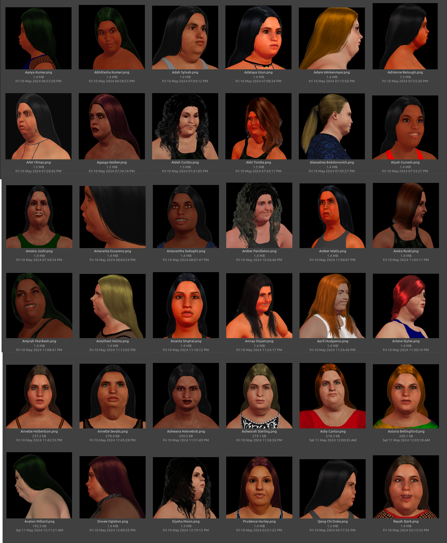

As promised many moons ago (life happens), I present the first batch of profile images depicting women with wattle jawls. Modelling this feature requires many slider adjustments, custom targets, and a lot of patience through trial and error. There are no hard and fast rules.
You will note that there are custom textures on the models, with the hair being the most apparent. I made these additional colors using the GIMP. I also used the GIMP to create the images below which are mosaics of cropped screen shots taken while the folder containing the renders was open on the desktop. In Linux Mint Cinnamon, you can set the thumbnail size and use a dark theme to make them stand out above their labels.
My monitor runs at 1920x1080 and the shell widgets take up some of that space. Thus, I cropped the screen captures to show only the folder contents. Since there are more files than will fit within the view, I had to take several shots and splice them together after cropping.
Large Ladies with Wattle Jawls
Click the image above to download. Once it is loaded, you can view it full size at 1719x2423 pixels.
