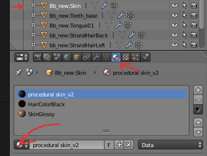

I seem to be too stupid to figure out how to transfer the skin shader. I did an append but have no idea where to look for it to add it in the node editor. :oops:
Help?
Help?
After you do the append go the materials panel while the body is selected then click on then material name button and select the new material you appended from the drop down list.
Re: Higher Resolution Textures please
Postby punkduck » Mon Jun 12, 2017 8:34 pm
blindsaypatten wrote:I seem to be too stupid to figure out how to transfer the skin shader. I did an append but have no idea where to look for it to add it in the node editor. :oops:
Help?
No, the node editor is the wrong place. You should do it in the default screen. Select the skin, then material and link the material, which you want to append to the skin. Okay too slow, loki1950 was faster. :lol:
After doing this go into the node editor and change it ...

Thank you both. I really thought I had looked there, perhaps I forgot to scroll down? Sigh.
