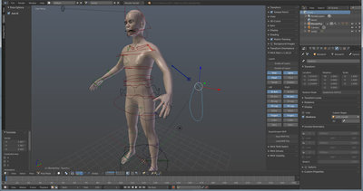

Is there a way to enable inverse kinematics for imported models to blender. Attached is a pic of what I've done. I exported the character as an .mhx, and it was imported nice and rigged, but isn't as fluid as I would like. I've tried turning on "Auto IK", but this hasn't worked very well either.

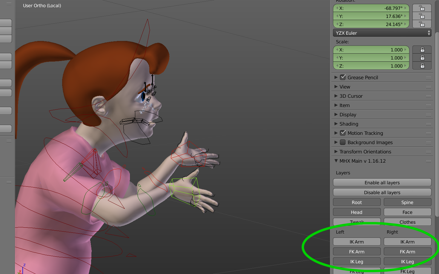

Yes, the MH Armature does indeed automatically have the IK option. The user can find it in the 3D View panel on the right-hand side of the screen (you open the panel with the "N" hotkey).
There are many other options for the Armature you'll find down there, too! See the attached image.

So I tried this, and it doesn't seem to work. The IK tools move, but the arm does not. Pic included.

You have not turned on IK, only the visibility of the IK layers. See the docs at http://www.makehuman.org/doc/node/mhblendertools_mhx_default_rigging.html, in particular this picture:

oh that worked. thanks a lot!
