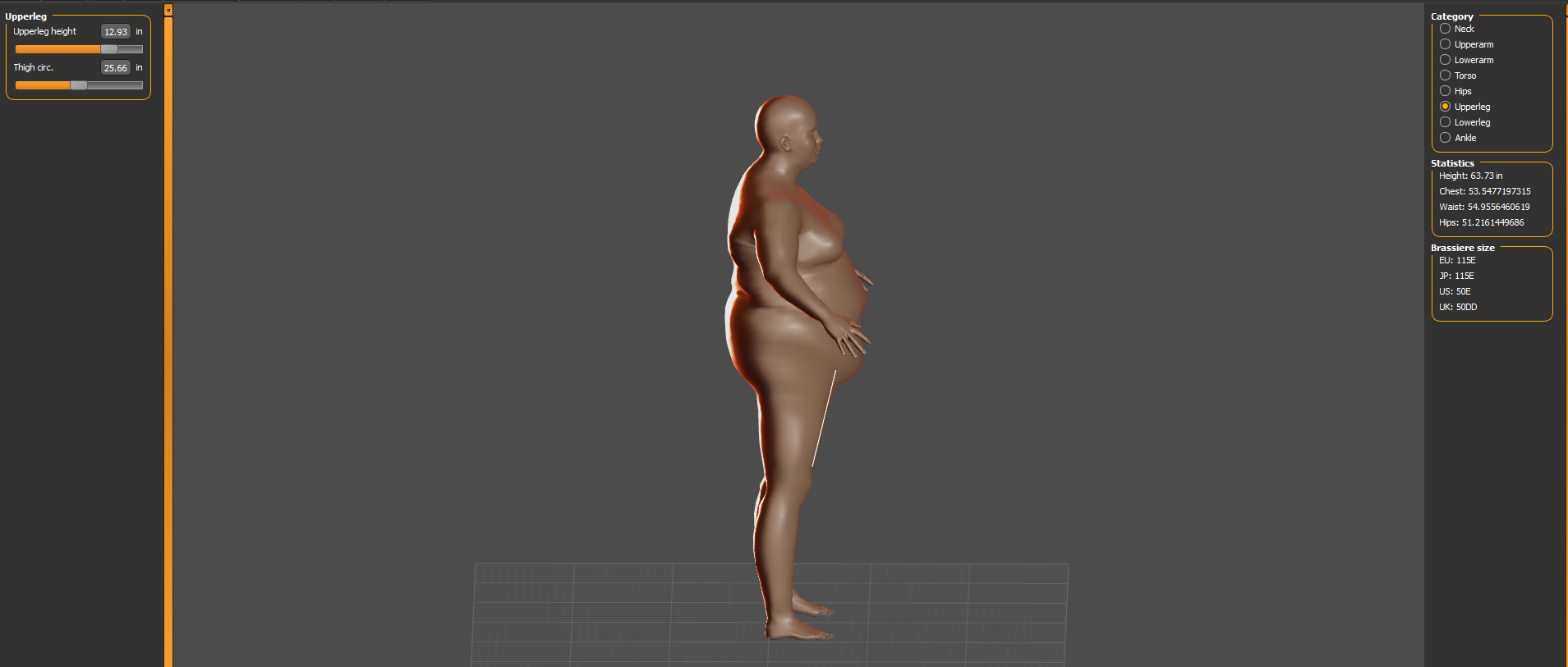

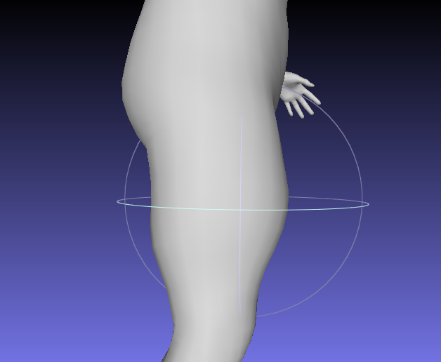

Yes, I believe brkurt was able to communicate my issue much more accurately! Well the front and rear of the thigh would be a great start, although I'm not sure if perhaps having control of the entire leg / buttocks could yield more realistic results as well. Perhaps, I could start with whichever is most easily available? I bet either strategy will help my sprinter leg issue.
Attached are two picks showing the same model that's 66 inches tall, 35 inch waist, 44 inch hips, and 25 inch thighs. As you can see, there is a bulge effect that doesn't look quite natural for normal women. At least, that's the feedback when I asked several women from friends and family : )
I need to accomplish a more even spread 25 inch thigh with limited bulge. Thanks!
(I'm using the nightly build from 11/15 Windows).

Postby Manuel » Mon Nov 18, 2013 8:25 am
Ah, ok.
This happens because the modifier try to act only on the selected measure without alter too much the other measures.
To solve this, we should add a selective "weight" modifier that can act only on arms and legs (as the old alpha5).
I started an issue for myself: http://code.google.com/p/makehuman/issues/detail?id=978
But I can't say if I've time to add it in alpha8.
