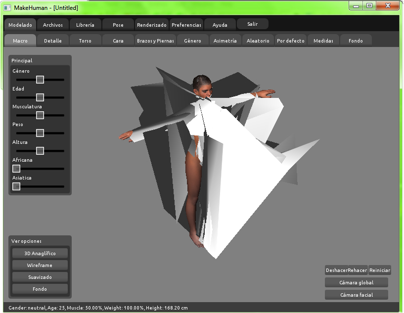

I just have created an armor with a kind of futurist in makeclothes, and when I try to use it in Makehuman it apears as an error thing of deformation. I didn't use textres for the model and it's mesh was not complete. like 5 meshes in one group. I don't have any images of the problem. But when I have it I must upload it. ¿Someone can help me?

Can you show us a screen shot, and describe how the clothes object was created?

Postby Yael » Sun Jan 27, 2013 8:08 pm
Here is a Screenshot:
I used Milkshape 3D to make the clothes, later exported to blender in .obj format. I use textures for the second time and the clothes are the same like in the screenshot...

Yael wrote:Here is a Screenshot:

I have the same problem. The clothing obj creates a triangular mess. The UV map mesh projection looked fine in Blender 2.65.
I noticed that the python window for MakeHuman gave an error saying that it could not find a texture.png file, since I had not created one (I guess I skipped a step). I created one by filling in the mask png with a single color in Gimp. Then I tried using the Clothes again and the python window shows an error about being unable to open data/targets/macrodetails/universal-male-young.target and same path universal-female-young.target. No clothes appear when this error occurs. The closhes that ship with MakeHuman still load fine, but not my MakeClothes data.
For these results I was following the documentation for making a shirt at http://makehuman.org/node/231 I just found a blog that gives an update to the documentation I was following at http://makehuman.blogspot.com/2012/02/making-skirt-with-makeclothes.html. It seems to be saying I copied the wrong python files for the makeclothes addon and need to get the scripts from another location. I will try following that tutorial and see if I get better results.
Is there any video tutorial on this? It usually is easier to determine where I may be skipping a necessary step when I see it done right and working in a live demo.
Edit: Right off the bat there is a problem with the blog. There is no makeclothes folder under the MH/utils or MakeHuman/utils directory. There is a makeclothes directory under MakeHuman/tools/Blender26x/ which is what I copied based on the shirt documentation. There is a date stamp on the Blog, but not one on the shirt doc, so I am not sure which is more current. Given that the responses to the shirt doc are more current and it refers to the Blender26x directory, which also should be relatively recent, I am guessing the shirt doc is the most current. But it is hard to follow for a Blender Newbie given the results this post shows we are getting.

I got the Import Base Obj to work by changing the Program Path in the Make Target buttons to "C:/Program Files (x86)/makehuman" instead of "/program/makehuman" on my Vista installation. That is not documented, but should be, or some kind of file browser capability should be enabled with that input dialog. So now the Base Obj is importing, which I did not do before. I will see how far this fix takes me.

I managed to get working results by following the Blog post skirt example, with some adjustments based on my comments and the shirt exampe. I found that the Make Target steps are essential. I also found that when my chothes vertice count matched or was below the vertice count of the helper geometry, the process work. I got an error that prevented me from completing the exercise when I revised my clothes to have noticably more vertices than the helper geometry in a noticably different distribution. I got the best result by duplicating the helper geometry vertices to a new object in Blender. After removing unneeded vertices outside of the clothing limits, I was able to sculpt or reposition the vertices that were within my clothing boundary to get the design I wanted and still have the makeclothes utility work. So the utility is twitchy, but it can be made to work.
