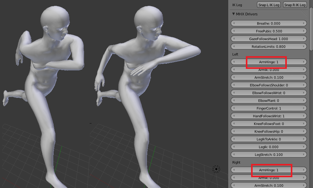

I noticed a bug in the retargeting of the mhx rig; the rig has apparently changed since last time I checked the mocap tool. The upper arms have weird positions, but if you set the Left and Right ArmHinge properties in the MHX Drivers panel to 1, things look better. WIll look into this.
ThomasL
Posts: 1139
Re: Current state of BVH imports
Postby ThomasL » Tue Oct 02, 2012 5:30 am
The hinge problem has been fixed in svn.
