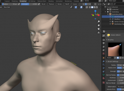

Say I want to make a StarTrek alien or something. Here are the steps I took. What am I doing wrong? What step is missing?
Using Blender 2.8.3.
Import a human from MakeHuman
Mark as Human in MakeClothes
Use Sculpt mode in Blender and make a change with the Elastic Deform tool
Create/Save Target
Put target in ~/Documents/MakeHuman/v1py3/data/custom
Refresh targets folder in Makehuman, new target has no effect.
I got this to work once, but now I can't for the life of me figure out how I did it.
I should mention this output produced by Blender. The Errors shown appear during sculpting, but not sure if they are the cause of the problem or what.

Decided to try again with Blender 4.3, had a little more luck, but an asymetrical result
Note that during the sculpt mode, I used the Mirror Modifier so that the sculpting is symmetric
Then I saved the target as "zzz6.target"
I closed and reopened MakeHuman and refreshed the target directory.
This time, the target is somewhat functional, but it is asymetrical?
Note that I tried pressing the Symmetrize buttons before saving to no avail
Thank you for any advice
