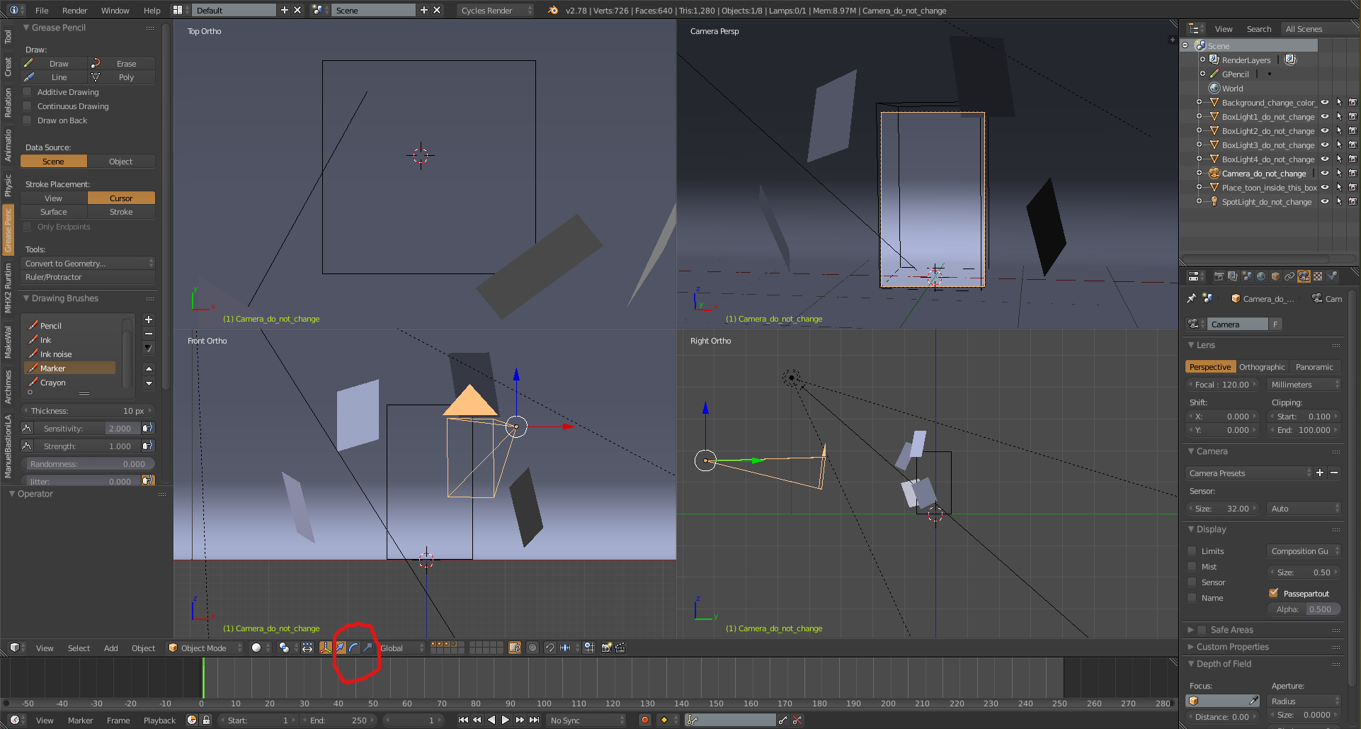

Select the camera now on the bottom of the 3d window on the menu strip just to left of the word global you see 4 boxes with icons the axis,cursor,curve and line with a diamond on it's end click on the curve while pressing shift this will allow you to both move and rotate the camera I have included a blender screen shot with box to click circled.

Select the camera object and press "r" to start rotating.
You can see how the camera object looks in loki's image.

Noticing that in the image the camera is called "Camera_do_not_change" sparked the thought that you might be wanting a rotated view of the model rather than a rotation of the camera. Rotating the camera will just move the model around in the image, which might be what you want, but if your goal is to get a view from a different angle it would be easier to rotate the model rather than the camera, particularly, as hinted at by the name of the camera, the lighting has been set up with the camera position in mind.
Presuming that want a different viewpoint and that you already know how to move the view around as you work in Blender, another option is to open the right hand panel on the 3D view (open and close with the n key) and under View click the "Lock camera to view" check box. That way what gets rendered is always what you see in the 3D view.
