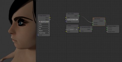

I know I should wait a few days before posting again but I remembered that I should put in something descriptive. The first picture comes from my computer. An attempt with the eyelashes in Cycles mode. I got the eyes to work, but the hair, brows and lashes, not so much.
This is one attempt with eyelashes with nodes

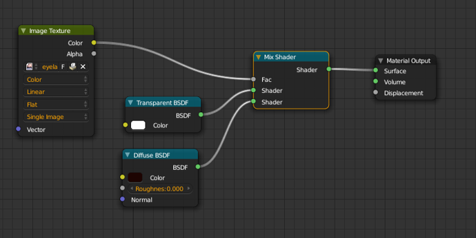

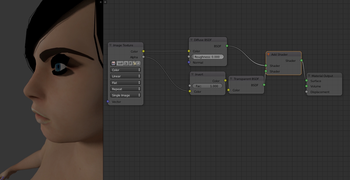

This is one of the eye lashes suggestions that I found online. It's from a site called CG Cookie Community. Someone had roughly the same problem I am having and they suggested the below Node setup. I tried it but I couldn't get it to work.
Found online
Any help would be appreciated.

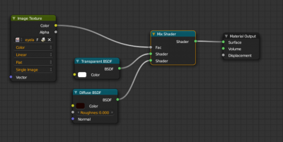

This is the node setup that is the default from mhx2 on import for both lashes and brows works very well for me.

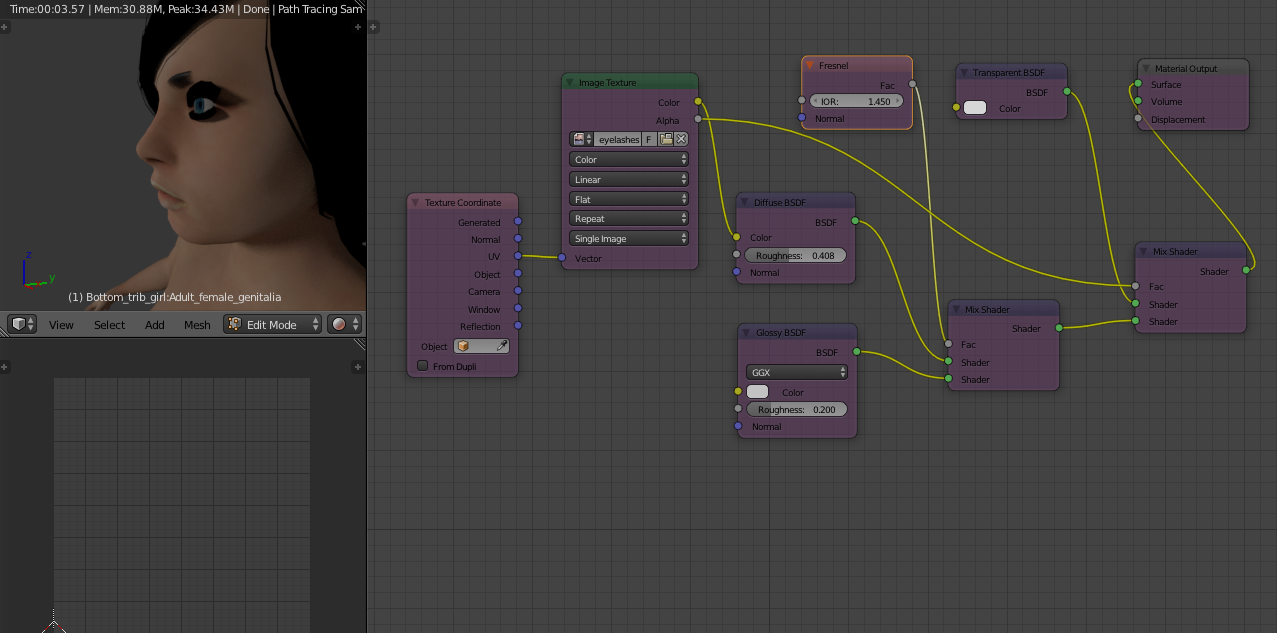

Postby ngc7293 » Tue Dec 27, 2016 11:00 pm
Okay thanks for the reply. I tried that but as you can see no change. I used the eyelashes FROM Make Human. I have OSX and went into the contents and found the file. I notice that you have the UV editor up but there isn't anything on it. Also Image Texture is connected to UV. Does that mean it needs to be connected have a UV map?
What am I missing?

Postby loki1950 » Wed Dec 28, 2016 12:05 am
That is not the UV editor but just an image viewer it can show any image format the UV map it actually saved as part of the .obj file of the item that is where the Texture Coordinates node gets it's info from from your setup try playing with the roughness value of the Diffuse BSDF node you have yours at .408 while mine is 0.0 that should make each hair visible and brighter lighting will also have an effect you notice that I use image based lighting just hdr skybox from a blender addon called scenesskies.

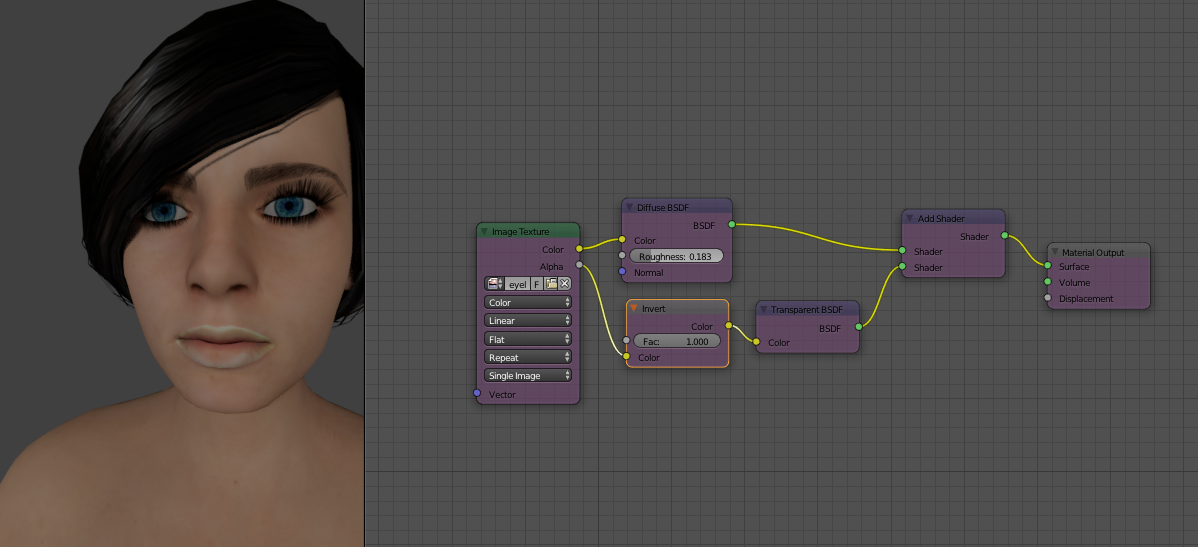

I uploaded this file. I promise I'm not making this up. I had this NOT working for a while. I had a black texture for the eye lashes (the wrong thing to use obviously) and then I used the correct thing as I tried different node set ups and they didn't work so I would exit without saving (no point)
This time, however, was different. I noticed that I had changed the eye brows with your Node setup. I went down the Eyelashes and changed to the eyelash texture and before I could change the nodes it was fixed as below.
Fixed?
This is that node setup for Hair from a youtube video. I used it for the eyebrows and it worked just fine.
I then tried it for the hair (after all, it worked in the video) but it doesn't work :evil:
