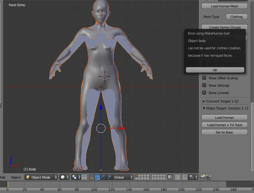

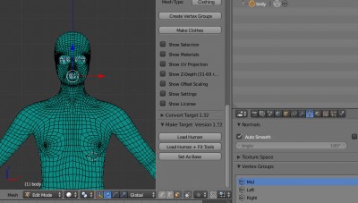

I used Makeclothes to do that but I'm having issues. First is that after I made a vertex group of my object, the mid area are partly selected & try all over again to create vertex group. Most of all, I can't make clothes because of error claims of non-quad faces. The thing is that I did double check & make sure the faces have them. Is it something to do with my UV Map being unorganized & not being re-unwrap after all the editing to the object?
