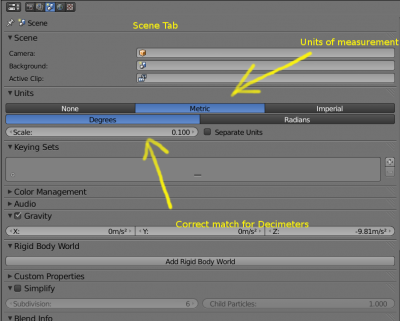

Postby duststorm » Wed Feb 05, 2014 5:42 pm
Indeed, you need to configure your units correctly in Blender, as shown in the screenshot.

Postby kenyb » Wed Feb 05, 2014 5:52 pm
okay I tried it and scaled it down to 0.10 and it came out correct. even in imperial it worked, so I was scaling wrong. Thanks Salty and Dusty....
