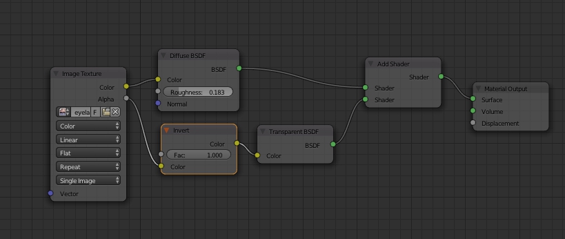

Though I will eventually learn particle hair, I am a slow learner so I will continue to use what is available. I downloaded what you uploaded about a month ago on December 7th. Long2_alpha7
I think this is the same hair used in a tutorial "Blender Cycles Tutorial- Make Human- The fast way." Anyway, I used a specific Node setup that has worked for the brows, and lashes that was presented in this tutorial for the hair. (I think it is at the beginning of this thread) I can't seem to duplicate the hair that is shown on your Evi character.

When I use your setup from the 28th of December then I have also problems with the hair. This setup seems only work correctly for real transparency on dark or black assets (like the eyelashes, eyebrows and the the hair style you have chosen, it is black or it is not there). I tried the original setup and yours in the compositor, took e.g. the ponytail and enlarged the preview box. Then I connected first the original to the material output and then yours. The difference becomes visible:
Your method simply does not work correctly for "semi-" transparent sections. All details are lost. The reason, and the thing I never understood, is how the Alpha layer (a single byte value) could be used as an inverted color (an RGB 3byte value) input for transparent shader :?: I guess a one byte value becomes a grey tone. Inverting a grey you will get another grey ;) ... and that means half visible for the transparent shader. Then using an add-shader :shock: ?! Each classical setup I know uses the alpha value as a factor of a mix-shader. In this case it is simply the amount of how much transparency should be used. The only thing is, that you can confuse both inputs of the mix-shader.

The alpha channel can be represented as a gray scale image, though, in fact it stores the information for each pixel how much of its rgb value is mixed with the rgb value of its corresponding background. You can use the node wrangler addon if you want to know how the texture looks like. You should avoid using the add shader node, this is mostly used for volume things...

Okay, I'm told I shouldn't use this. But it works for the lashes that come with MH. It works with the eyebrows that come with MH.
It was shown to work with the one tutorial where the guy was not using version 1.1.0 MH hair. He was using hair that was exported from 1.0.a7 MH.

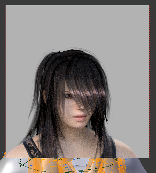

Sigh, getting slowly closer. Why don't you use lokis node setup (download/file.php?id=3861&mode=view)? This can be used for almost every material setup on MH. Back to your hair material: the hair info node only works with particle hair, but you are using a mesh hair with a texture. So, you need a texture coordinate node! And the Texture is uv-mapped, i.e. you have to plug in the uv-slot! This node setup is valid for hair, eye brows and eyelashes and should basically work with clothes that have transparency, though it could get more complex if you want to mix in normal-, bump.-, specularity- and ao-maps. BTW, the node input and output slots are color coded and only corresponding colors should be connect, though every rule has its exceptions.

Postby ngc7293 » Tue Jan 10, 2017 9:32 pm
Thanks for the information about the Particle system only Node.
About the Lokis node setup. Here is what it it looks like with lashes:

And here is what it looks like with Hair:

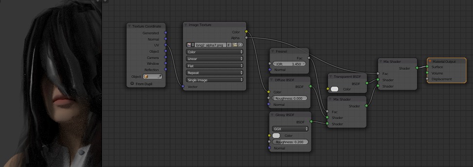

Postby Aranuvir » Tue Jan 10, 2017 10:48 pm
Indeed, this material isn't easy to use. You can control the effect of the alpha channel with a color ramp and you need to reduce the glossiness. I simply mixed the alpha channel to the fresnel node (see my node setup.
Perhaps set the mix color node to multiply.
