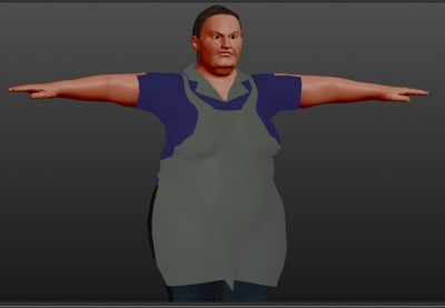

to make things clearer, there are 3 clothing pieces for which I had modeled in Blender and using some of the helpers. The list is as follows....
  1. the shirt, which I had used the upper part of the tights helper.
  2. A pair of jeans, which is the lower part of the tights.
  3. The apron, which is a combination of the upper tights helper and the skirt helper.
[/list]
I cannot see why "the shirt hides the apron" a bit confusing, but if you want I will explain it to you.
Typically, when people want to protect there clothes from getting ruined, they usually put an apron over there clothing prior to cooking or serving food. However, in my case, MakeHuman is placing the clothing on top of the apron instead, or that is what it appears to be doing. I guess your confusion was, why would someone put an apron underneath there clothing, which would not serve any purpose, so you could not see how it could happen in MakeHuman? :roll:
As a matter of fact, Aranuvir has even explained this to be one of MakeHuman's weakness, and layers of clothing have to be carefully created with vertex grouping, which confuses me, because V-Scorpian-C has mentioned in her tutorial, that you only want to have a mid, left, and right vertex group. So if that is so, then how do you manage layer separation, with only using a mid, left, and right vertex group????

The easiest perhaps is then to leave the shirt and jeans as one, but separate the apron... this allowing you to set the Z depth of the apron separately from the clothing.. i am not sure why you would have combined the skirt and upper tights to make the apron, this in my mind would cause confusion to the programme as these are different helper groups. perhaps this is half the problem because if it is reading the apron as tights, then perhaps it is pulling it in close to the body, not that it should, but hey you never know when it comes to programmes.

Actually, I beginning to think that o4saken is partially right as far as MC being confused with my outfit. Just as a test, I made a simple full gown by mixing duplicate templates of the top part of the tights and the skirt. To see if I could fix the confusion of mixing the 2 helpers, I applied new vertex groups to only the tights of the human mesh, and it finally imported correctly. Before, I was only following V-Scorpian-C video tutorial explaining that all of the vertices from the human helper mesh needs to be regrouped and match the same names that are in the clothing, which I am concluding is the wrong way. So now I am going to try it with my actual clothing I want to use in MakeHuman, and I will get back to you all with what the outcome is.

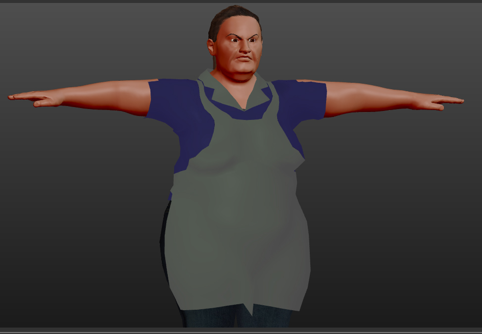

Postby rn216cc » Wed Jul 20, 2016 8:02 pm
Okay. So here is a screen shot of my outcome, which I am pretty pleased with. Sure, it could still use some tweeking, but the point is, these minor glitches, are nothing compared to my first attempt, and it is all thanks to guy's support. BTW, can you guess what this lady is going to be in my video game. I will give you a hint, She works for the highschool in my video game.
