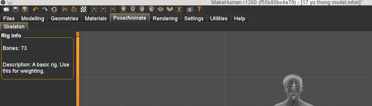

I wasn't expecting this forum to take off while I was away doing the Christmas festivities. I'll read up on it but the problem is that I am on OpenSuse and know next to nothing about what I'm doing. Also, I somehow have 2 versions of MH on here and don't know how to remove them and get the one version that is up to date.
EDIT:
Okay, up to date now but still don't know what to do. LOL I have MakeHuman 1.0.2 and 1.1.0 (r1260)
1.1.0 Gives me more options such as hair and clothes and my expressions and pose folders are there but MH seems to ignore them. Here is what the post screen looks like:

Postby loki1950 » Mon Dec 28, 2015 10:35 pm
That's funny since the latest revision number on the window title should be r1968 so you are missing about 700 updates to the source code so which link did you use to download it should have been https://bitbucket.org/MakeHuman/makehum ... efault.zip if that is the link you used are you starting the program from the menu as opposed to double-clicking on the makehuman.sh in the folder that you extracted the zip file to the zip file does not edit your menu automatically as zypper does,Linux assumes that you do know what you are doing :shock: and does not hold your hand,leaves that to us to do 8-)
