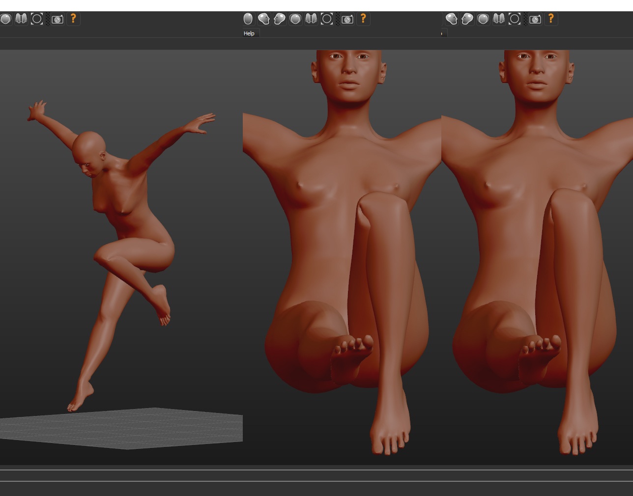

im trying to create targets that fix pinching and distortion in extreme poses. the easy way to do that would be to actually pose the maketarget obj, adjust the vert positions, unpose the model and export the target. now im having trouble finding a way to do this accurately as the maketarget obj and the base mh model dont match. im guessing jujube's base test.target could help me create a MH base character that i could export an fbx to work with.. but i dont understand how that target is actually supposed to function it gets all crazy. thoughts?

Thanks! my biggest problem is i dont know blender but im pretty good with max. i found a way to do this that is really overcomplicated. 1. exported base human on default rig as fbx and an obj with jujubes target at 100%. 2. merged that fbx, obj and the maketarget base obj into max scene at same scale. 3. applied the jujubes obj as morphtarget (shape key) to my base fbx and adjusted it until the geometry exactly matched the maketarget .obj. (exactly 50% strength) 4. skinwrapped the maketarget obj to the rigged mesh. 5. hid the rigged mesh. 6. posed skeleton edited maketarget obj. 7. unposed skeleton 8. exported maketarget obj. it worked! but damn.. now that i know the strength of jujubes target should be 50% if i could set exactly that in MH i could just export an fbx skinwrap and edit. would be a little easier. is there a way to set exact target strength in MH?

if anyone is curious i uploaded a lotus pose and corrective target. its not a perfect fix it was more for testing than anything. i will probably do this as part of mypose creation pipeline from now on. It will help me personally quite a bit. in testing it seems this is going to be more helpful to me to have a per pose corrective target as opposed to combinations of joint specific corrective targets as i originally planned to do. not sure if these will be useful to you guys if so let me know and ill add them with poses that need them
