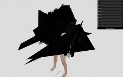

this sort of works unless i add offsets. the moment i add the offsets (even without scaling) it breaks the whole geometry.
a potential source for this is that, gltf exporter in blender adds duplicate vertices when you export uv data (for example base mesh has 19158 vertices in blender, but 21833 in three js). i solved that by creating maps that maps original vertices to duplicate ones, and they work fine when aligning the skeleton or hiding helper parts of the geometry. but still maybe they mess up offset calculation somehow? or my implementation is wrong altogether?
with and without offsets:
EDIT: in the meantime, i found out that adding another factor to the scales kinda works. mesh gets a bit squishy, but definitely much better than before.
