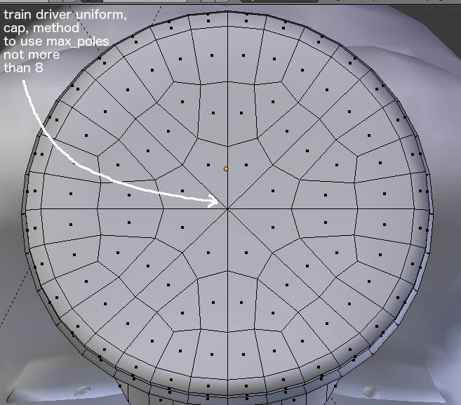

Postby punkduck » Wed Jun 28, 2017 7:57 pm
blindsaypatten wrote:I'm just curious, will MakeClothes even produce output if the mesh contains non-quads? I have always just gotten error messages.
I just tried it, 2 triangles: MakeClothes does not complain. 2 triangles and 1 rectangle, "you cannot mix ..." :?
I guess the complete object is made from triangles. Otherwise MakeClothes should complain.
If not there is another chance: increase the max_pole value in .mhclo file manually from 8 to 9 with an editor. I got the problem often, but is was more like MakeClothes created a max_pole value of 5 and I had 6 edges leaving a vertex. Maybe 8 is the limit. In this case you should do a change in the topology. Here is a picture how I changed the triangle fan used for a dics in Blender to something MH could handle:
http://www.makehumancommunity.org/forum/download/file.php?id=4130&mode=view
