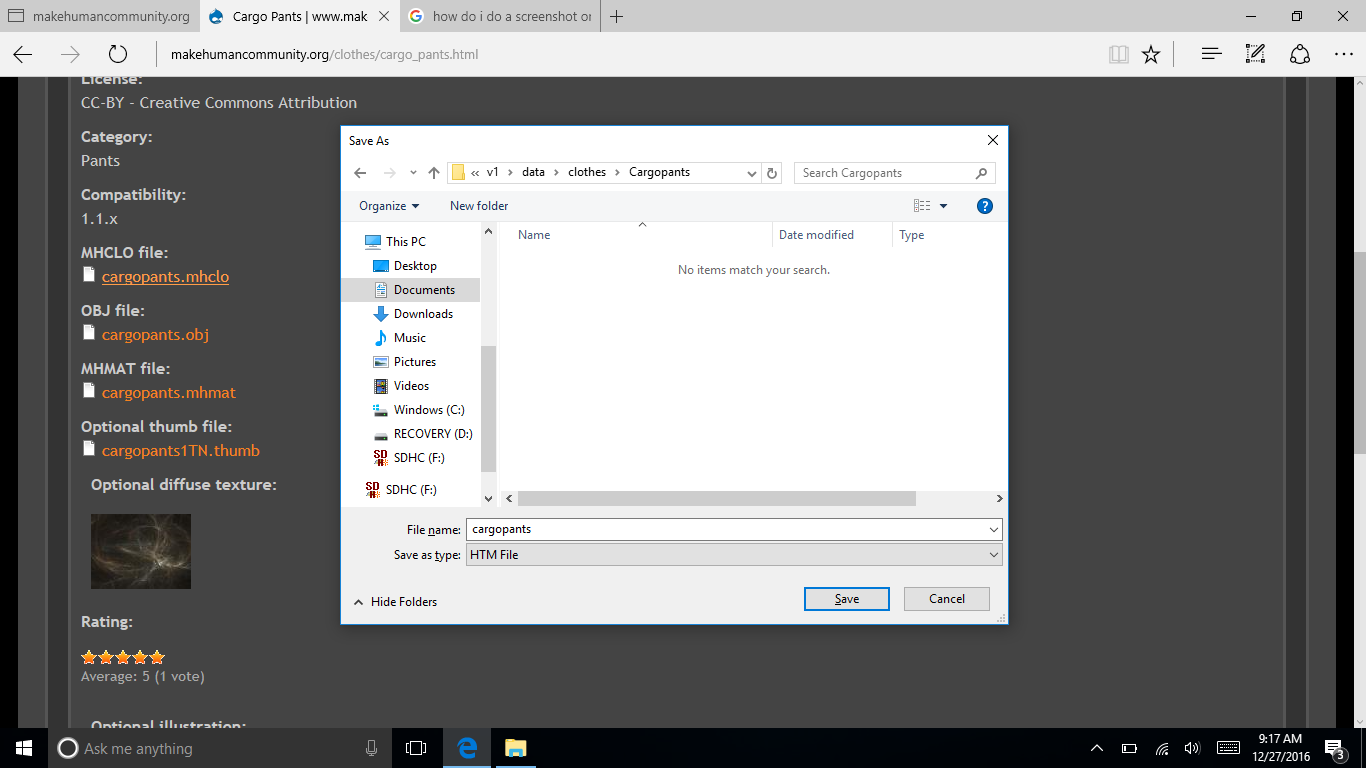

Ok guys please don't make fun of me as I'm new to the 3D world. I hope I'm posting this in the right topic area. I have already watched a ton of youtube videos and read a ton of webpages but nothing seems to explain what I'm doing wrong. I have downloaded MakeHuman 1.1.0 and Its awesome. After playing around a while I decided to download some stuff from the user contributed assets from the make human community. However every time I try to save the files with (save target as) the files will save as a HTM file and not at OBJ file. Both the .mhclo and .obj files do it. I cannot change the file type at all. I have attached a pic of what I'm talking about to better illustrate what I'm trying to say. Please any help would be great, its driving me crazy!
Thank you
ogfd129
when I right click to save target as .obj files saves as HTM

This is a known problem which you are not the first to run into. It is a problem with your web browser (probably IE or Edge?), which makes assumptions about file extensions. The quick fix is to use Chrome or possibly Firefox.

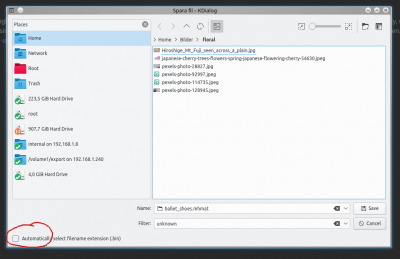

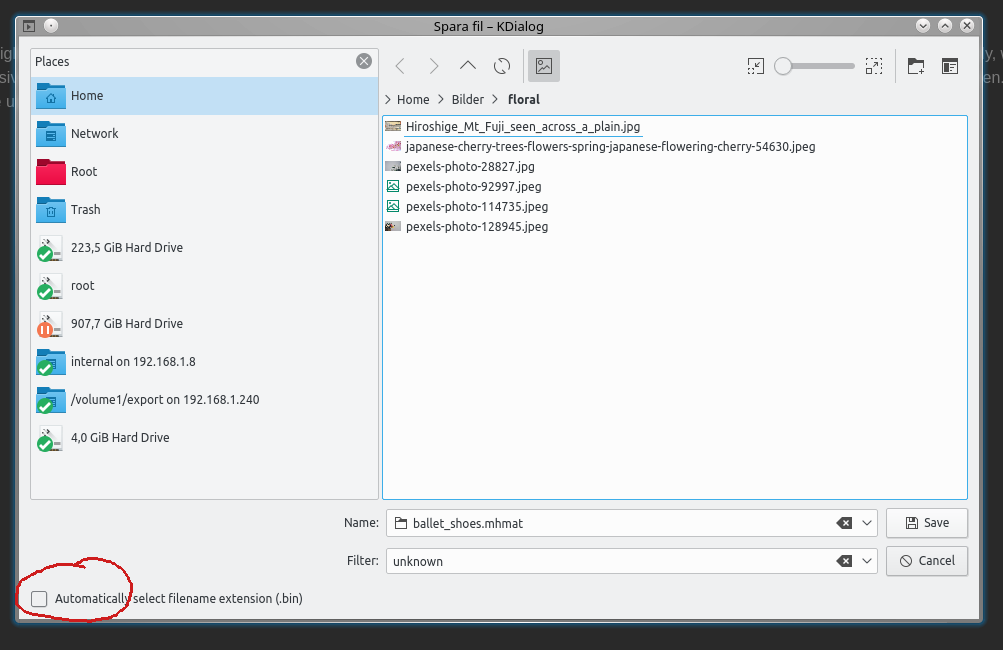

In chrome, you get a checkbox for overriding the behavior:
