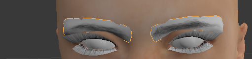

Postby Antisanta » Tue Dec 20, 2016 2:23 pm
I'm completely new to using blender so please explain everything, thanks.
How would I fix this?

Postby RobBaer » Tue Dec 20, 2016 2:30 pm
I am assuming you show us an image from Blender Internal Render. If so, you might wish to read this: http://www.makehumancommunity.org/wiki/ ... to_Blender There are similar instructions for other downstream programs at: http://www.makehumancommunity.org/wiki/ ... _Workflows
Some of this will be taken care of for you if you are using Blender and get get Thomas's .mhx2 plugin: https://thomasmakehuman.wordpress.com/m ... mentation/
Have fun.

Postby Antisanta » Tue Dec 20, 2016 3:20 pm
RobBaer wrote:I am assuming you show us an image from Blender Internal Render. If so, you might wish to read this: http://www.makehumancommunity.org/wiki/ ... to_Blender There are similar instructions for other downstream programs at: http://www.makehumancommunity.org/wiki/ ... _Workflows
Have fun.
Thank you!! It has work so far with the eyes, but not the eyelashes...

Postby Carlossedd » Wed Dec 21, 2016 12:21 am
I had similar problems. Before you import, at the top, where it says Blender Render, change it to Cycles render. That should be a quick fix.

Postby loki1950 » Wed Dec 21, 2016 1:12 am
Carlossedd wrote:I had similar problems. Before you import, at the top, where it says Blender Render, change it to Cycles render. That should be a quick fix.
Only if you exported with mhx2 as the OP stated he was using .dae (collalda)which does need tweaking of the materials settings in blender besides clothes are created for blender render not cycles and eyebrows and eyelashes are considered as clothes you use makeclothes to create them.

Postby RobBaer » Thu Dec 22, 2016 1:35 pm
Antisanta wrote:
RobBaer wrote:Thank you!! It has work so far with the eyes, but not the eyelashes...
I could be wrong but it looks like you are mixing up eyelashes and eyebrows when you say that. Make sure you have done each of them separately.
