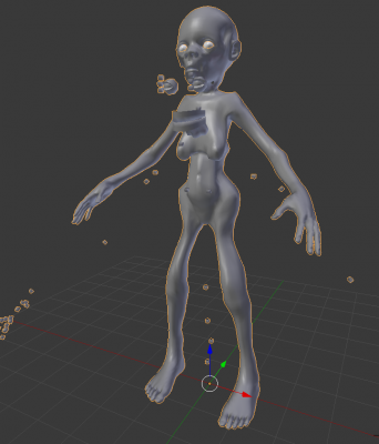

When I bring in my new sculpted obj file from Zbrush it has the base mesh and the eyes, I can now make the target for the body but the eyes disappear.
I have tried to parent the eyes by dragging and dropping them onto the base mesh in blender but the same issue is still there, so whats the trick to make the eyes and mesh morph correctly.

I create a body shape in make human and export it as a mhx2 file.
In Blender I import the mhx2 file then using make target I load human, then selecting my mhx2 file first followed by the maketarget human figure i press load target from figure.
It all works well except the eyes teeth and mouth parts do not morph aswell .
The idea was to then shape the model in Blender and save as a target I could then apply to the MH base I had previously shaped.
But I am suspecting I am going about it all wrong.
Bluemidget666
Posts: 6
Joined: Sat Mar 05, 2016 3:00 am
Re: MH & Zbrush
Postby loki1950 » Mon Mar 07, 2016 4:17 am
Like I mentioned earlier targets only work on the base(or average male/female) mesh that is part of the blender maketarget so only that mesh loaded thru the addon will take a target period,the intended workflow is create a base character in MH import to your sculpting software work on it there there is no going back to makehuman as at that point both vertex count and order have changed and just will not load into MH.
