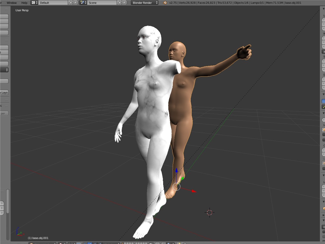

The 'Booltool' is a great tool for blender and simple to use when you want to cut off parts of your mesh. How it works is explained here https://youtu.be/j2uOjh6CDiM (german) and other video tutorials.
