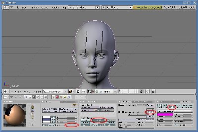

I have rendered a model in blender. But the eyes, eyelids and eyebrows weren't rendered correctly. It's strange, because when I activated Texture Paint mode in blender, they were shown correctly.
How can I render correctly?

@ b!d:
Try these material-settings:
Then your render should look like this:
greetings

Postby b!d » Fri May 22, 2009 3:29 am
@ezteban
Thanks !! It works now.
