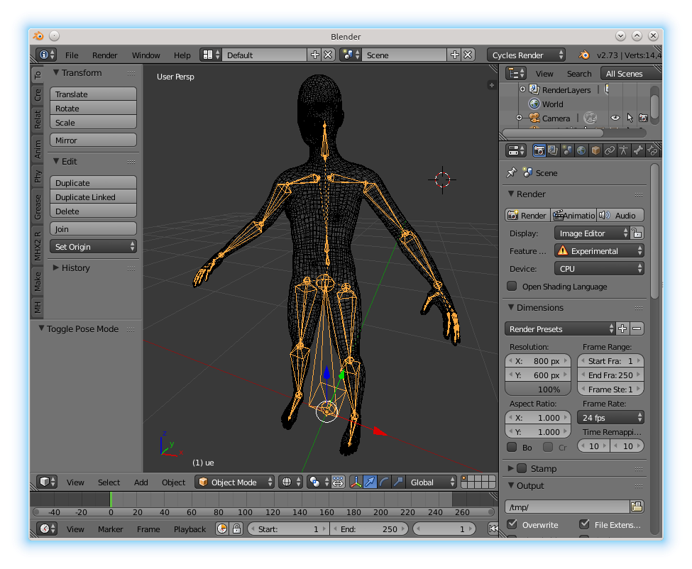

I need to import the MakeHuman model with the Uengine skeleton to blender but after the import i have this problem:
also in blender i have not a lot of options to modify/animate the body :\

Postby joepal » Thu Apr 23, 2015 12:18 pm
Works for me
Maybe you could try using standard formats instead of MHX2? I used export/import as collada.

Postby Aranuvir » Thu Apr 23, 2015 3:58 pm
I suppose you are trying to import a model in T-pose. This didn't work for me, too, tough I just tested the default rig. Importing the mesh without poses should give you the result like Joel's.

Postby ThomasL » Fri Apr 24, 2015 9:04 am
This bug was fixed this morning, I hope. Stable mhx2 v 0.26 has been updated, too.

Postby Aranuvir » Fri Apr 24, 2015 5:45 pm
Thanks Thomas!
Tested with MH r1774 and MHX2 from trunk (=v163 ?) with T-pose and standing06 for the default skeleton. Now both import correctly on Blender 2.74.
