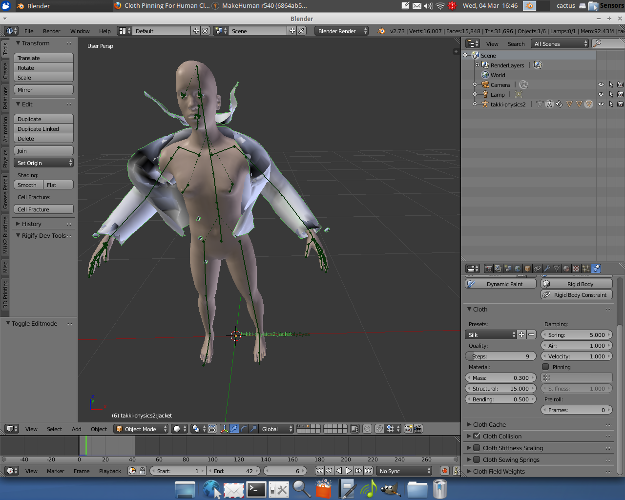

I'm trying to use cloth physics with a Makehuman character in Blender, but after applying cloth for cloth and collision for the body the clothes wiggle and or "explode" insanely?

This is due to intersections in the cloth materials and lock of proper pinning. Cloth sim is very fragile and only works under perfect conditions. Unless you make an outfit specifically for it, it doesn't work. MakeHuman clothes are designed to work with bone deformation, and so are not built to work with cloth.
If you want to get cloth sim working with makehuman clothes, the best approach would be to set up a simplified Deformer object, run the cloth sim on that, and have it deform the MakeHuman clothes. If you want to try this, search google or look on BlenderArtists for info on setting up deformers.

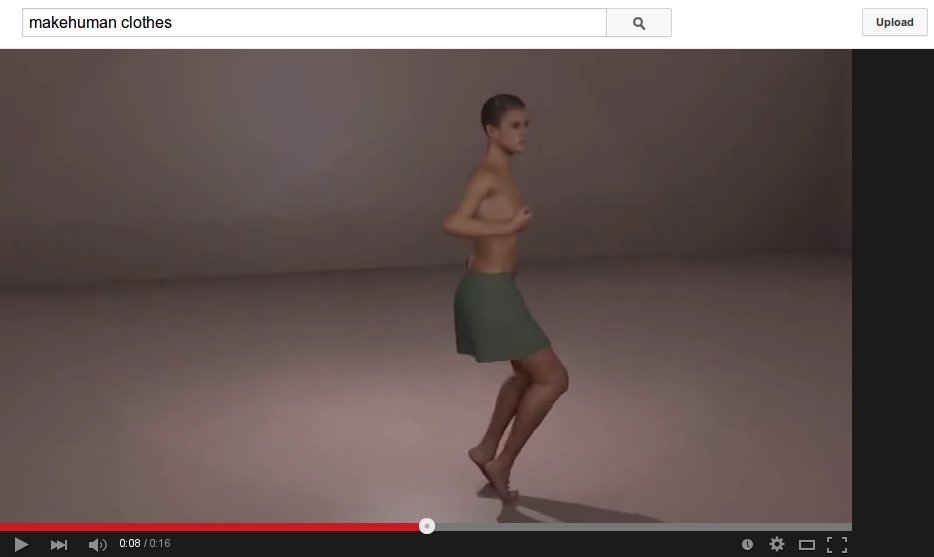

Oh no! Well, I have to stick with the basic bone/cloth deforming for now. I just got too excited when I saw this in Youtube: http://youtu.be/t9qHg-NrGOY
But, I think that it is very simple piece of cloth in this case then. Making still photos and wrinkles there is some use for the cloth modifier...

Cloth simulation like the one you see in the video indeed works pretty well, but if you look closely you'll notice a quite large gap between the upper part of the skirt and the body. It's the result of a fairly high distance setting in the cloth collision tab. High distance settings generally make the simulation more stable, but the result is quite unrealistic like in the video. Low distance settings increase the risk of simulation going nuts.
A workaround could be to use a solidify modifier after cloth simulation to make the gap smaller. Real clothes have a thickness.
