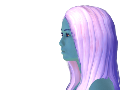

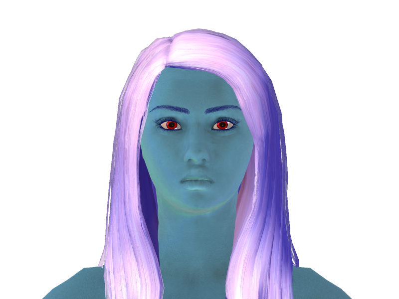

About what i did so far, i kind of start to stop try to make kwak ji min and to focus on making a nice girl.
So:
Yinyin face
Yinyin three-quarter
Yinyin profile
I used stock hair, and i know that there is collision problems with shoulder (and it gets worse with clothes) but it'll be enough for me. I'll fix that later if i know how to do it and if i find the time to do it.

well, i made a mistake : the blue tone on the pictures is here on purpose. I am designed an human-like creature (but not really a human).
Sorry, this is not a bug. And thanks for the reply. I understand that you are busy, no problem here. And, as vairon is not something i picked from my imagination (it exists in real life) i can't say to you if it's only a difference in colors or a difference in materials/shape/whatever. I think only the color change, but the possibility to affect a different texture to each eye would be awesome. You would be able to have a perfect-white eye (blind), a terminator-like eye ect.

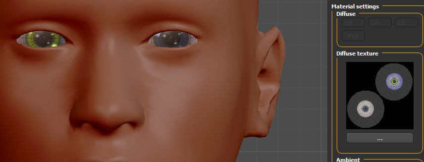

As i said, it works, congratulation. But, there is a problem. Here is a picture.
As you see, to have a roughly right eye's size i need to have very little eyes on the image. Also, i think that the layout of uv mapping are not optimized.
I tried to do what i could.
Here are two blender files with the result, and the procedure to re-make it if i made a mistake that spoiled the file.
The file (zip, blend files are not accepted):
eyes.zip
(196.69 KiB) Downloaded 341 times
The procedure:
1/open blender
2/load the obj file
3/split the area. In one area, display the uv editor
4/go in ortho mode (numpad 5), then make the camera facing the eyes (numpad 1).
5/select eyes, then go in edit mode.
6/press "p" and select "by loose parts".
7/in the uv area, in "UVs" check constrain to image bounds.
8/one eye should remain selected. If not press a (with the mouse over the view area), it should select everything.
9/unwrap with the option "project from view (bounds)".
10/place the mouse over the uv editor area, press a.
11/press s, then x, then "0.5", then enter.
12/press g, then move the result to the side.
13/go in objects mode, select the other eye, then go back in edit mode.
14/repeat steps from 8/ to 12/ (and move it on the other side, for step 12/).
15/go back in the object mode, select both eyes (a then a again if one eye is currently selected).
16/press ctrl+j.
You can load an image to see the result (go in textured mode).
I'll try to create a thumb (it's a png, i know) for these two eyes. Also, if you don't want to transform these .blend in .mhclo (and i can understand that, you have better things to do), maybe you can redirect me on a tutorial or give me an hint on how to do that.
It's my first uv mapping (the first time i succeed in doing something with blender too, except files conversions and smoothing)
EDIT : for the thumb, i did that:
I can do the same for the high poly.
However it's not very beautifull. I don't even know if we will keep this approach (have different mhclos for vairon and standard eyes), as a solution would be to always use the vairon model and on-the-fly duplicate the texture if a checkbox "use vairon" is not checked.

I see the problem, it was my fault since I done them very quickly. Sorry.
Anyway, since another user asked for a similar feature (viewtopic.php?f=4&t=10870) I create an official issue for them:
So I'm going to convert all existing assets. If you can wait, I'll provide the new models the next week.
UPDATE:
I missed the part where you ask about this...
I think we should have vairon as default for all, because it's more flexible, since it can be for both symm and asymmetric characters.
For this reason I'm going to replace the old assets with these...
