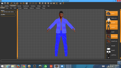

Hello guys, I am new to Makehuman. However, on my first use, when I select some clothes, the color is violet which may be UV maps(?). Is there any setting or configuration I forgot to use or should I reinstall? I tried rendering the model but it is still the same. Also tried restarting. Here is a screenshot.
As you can see, the jacket, the jeans, and the shoes are violet but not the fedora hat. What is the problem here? Any help would be appreciated.

cc67 wrote:What is the problem here? Any help would be appreciated.
Probably that you are running MakeHuman on Windows and you have an intel graphics card.
You are seeing the normal maps instead of the diffuse texture.
Best to disable shaders by running makehuman with the --noshaders commandline argument
