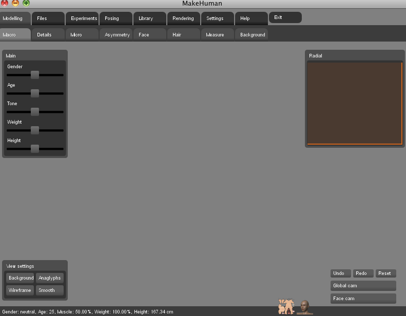

I just installed MakeHuman on my Mac OS X 10.6 and opened it up. The MakeHuman: A Manual says a person show show up, however I just see an empty space. Is there something else I need to do?
(I uploaded a screenshot too)

If anyone gets this, just download the nightly build instead. Then a model shows up.
However, it's a weirdly rendered see-through model, as if something still isn't rendering correctly. Anyone know why this might be? (Attached image)
