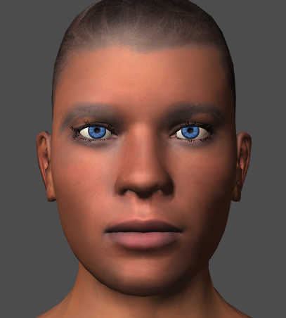

I used the png of the blue eye iris to create a standard eye png in the library. It is static like the other mh eyes, but at least it gives me a nice blue eye (See screen shot) It was not difficult to set up in gimp.
Are you able to produce other color eyes with this shader? Grey, hazel, Amber, etc? http://en.wikipedia.org/wiki/Eye_color Where in the code is color controlled?

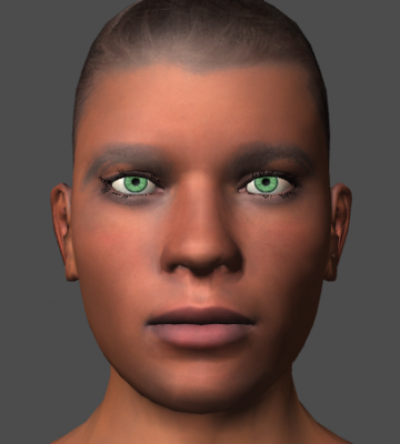

Postby rfairhurst » Sat Apr 13, 2013 7:50 pm
Using gimp I have been able to do variants of blue and green from the original iris png above. I am not very happy with the light-brown eyes, but it has some use still. The first is the original (which I am calling light-blue) and the rest are the variants I made with Gimp.

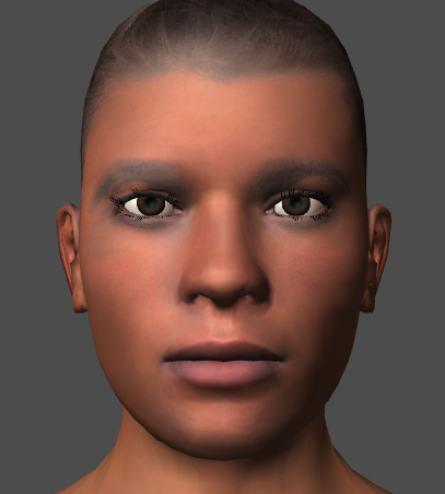

Postby rfairhurst » Sat Apr 13, 2013 8:17 pm
Here is a dark brown with slightly larger pupils as compared to the original brown. I have made them more doe eyed, but that can be lessened without a lot of trouble.

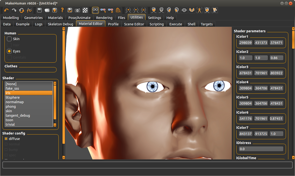

Postby duststorm » Mon Sep 30, 2013 3:52 pm
I experimented with this shader today and managed to get it into MH without too much effort.
Behold:
Iris shader at work in MH
I extracted some of the color values that you proposed to be editable and made them uniforms so they can be configured.
As you can see on the screenshot the material editor (Utilities > Material Editor tab) allows you to tweak the values and preview them in MH.
Eye shader closeup -- without texture backdrop
I also added the option of using a texture for the white area of the eye, activated by clicking the Diffuse checkbox (which enables diffuse in the shadingConfig, and defines the DIFFUSE preprocessor directive in the shader code).
