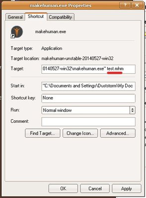

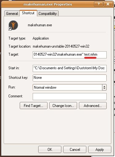

zoiner wrote:Been ages since I looked at BAT files but I should be able to generate a simple script to run from the desktop.
You don't even need to make a .bat for it. Just create a shortcut to makehuman.exe and modify the target line in properties.
Modify MH shortcut to automatically open a preset file
It only accepts a certain maximum length, though, so you might need to be original where to locate that file.
"C:\users\documents\makehuman\v1\models\test.mhm" fit the field, but Windows XP users will have to be a bit more creative, as the whole "Documents and Settings" cruft did not fit (who invented that, anyway?).
Note that MH expects a correct absolute path to the file, the screenshot above with only "test.mhm" appended is purely for illustrational purposes. Unless you copy test.mhm into the folder where makehuman.exe is located, you will have to put the full path in the Target line.
