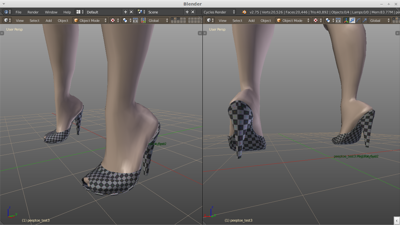

I think i got it now. No high heel target needed, just an armature for the cloth human.Yeah!!!

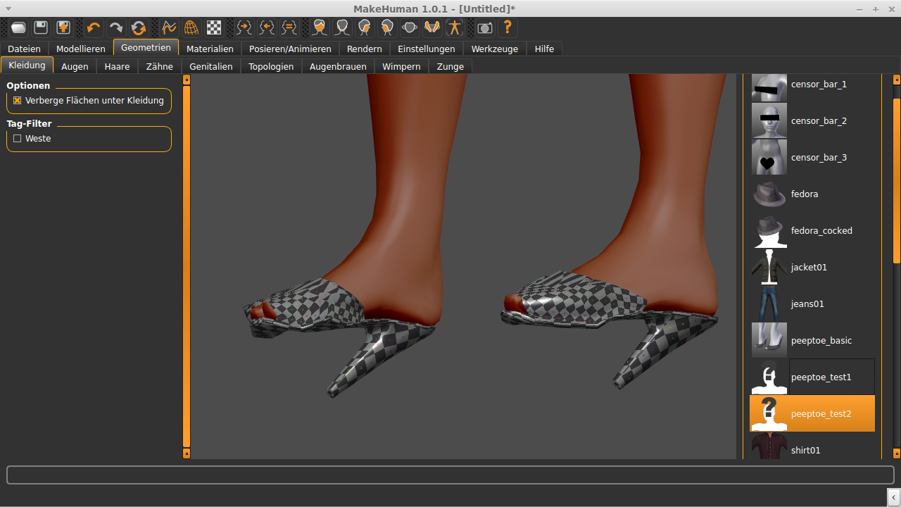

I now run the latest version of MH (1.0.2), but i still have no data/special_poses folder. I created that subdirectory manually, and i stored the bvh there. I also placed the script-line inside the mhclo file of my best heels, but since i don't know where to put it i placed it at the very bottom, right below the vertex data block. Maybe this caused the issue? When i opened MH and selected the heels, they didn't show up any more. After deleting the code line and reopening MH, the heels showed up again.
