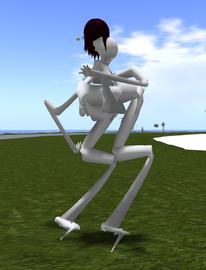

The mhx2-exporter did not install in MH, so I tried the direct way. Set T-pose in "Pose/animate" in Makehuman 1.1, select export option as dae-file, upload to opensim, and the result is this nice spider :lol: (Blender shows the reason why: the skeleton is placed beside the mesh)

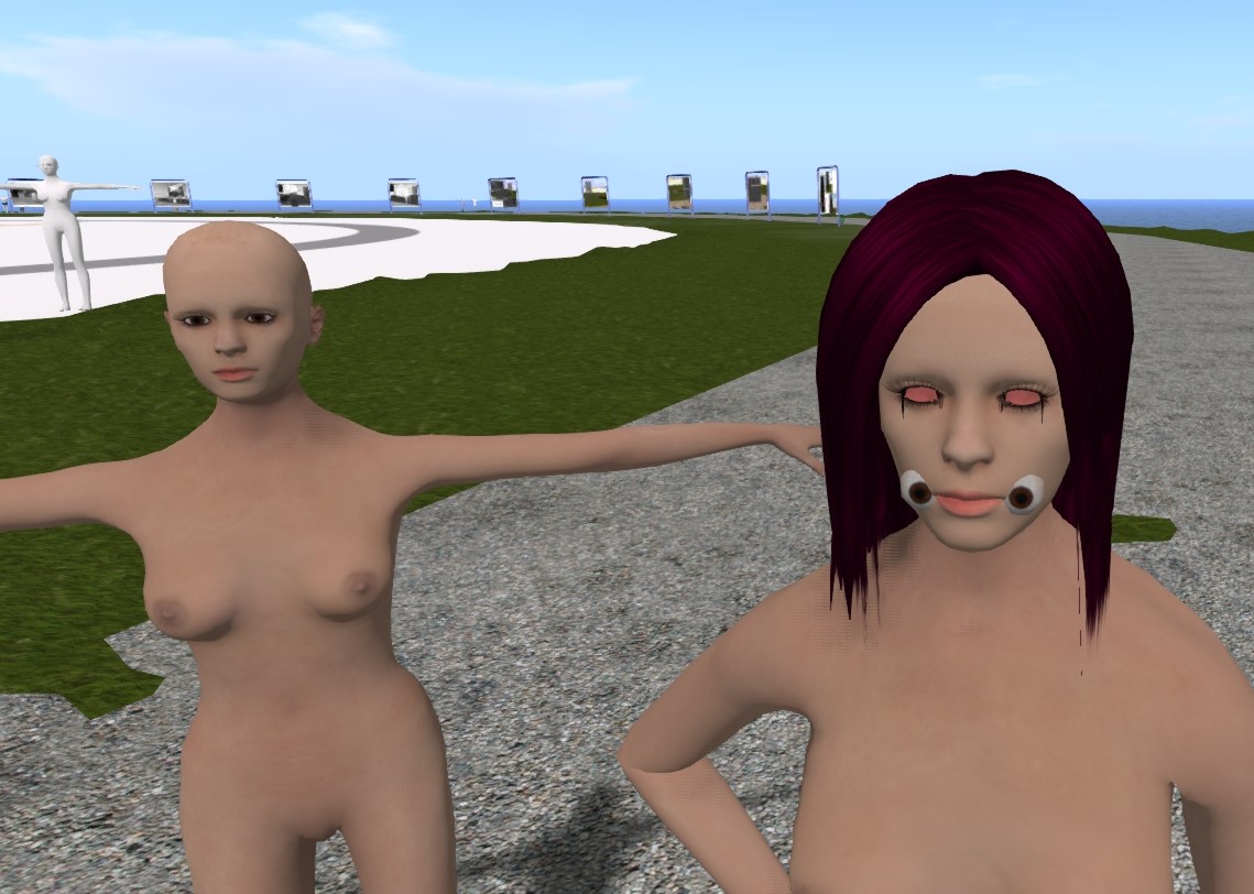

Okay, next try: saved as dae-file, rotation Z up face -y, import to blender, set t-pose with makewalk utilities, rotate, export, upload to opensim. The mesh (left) looks right, but worn as avatar (right) :cry: what has happened to the eyes???

Postby Manuel » Sat Nov 01, 2014 7:17 pm
If you try latest nightly build, there is the new secondlife skeleton, that should fix all these problems.
It would be very helpful to test it.

Postby Déesse » Sun Nov 02, 2014 6:39 pm
The latest nightly build (today), the same problem with the eyes ...

Re: MakeHuman and OpenSim
Postby Manuel » Sun Nov 02, 2014 11:33 pm
Déesse wrote:The latest nightly build (today), the same problem with the eyes ...
Stable or unstable nightly build?
How many skeletons are available in it?
What have you done exactly?
